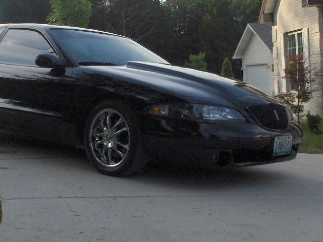

yes but it was not me

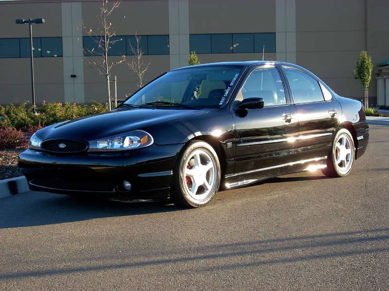

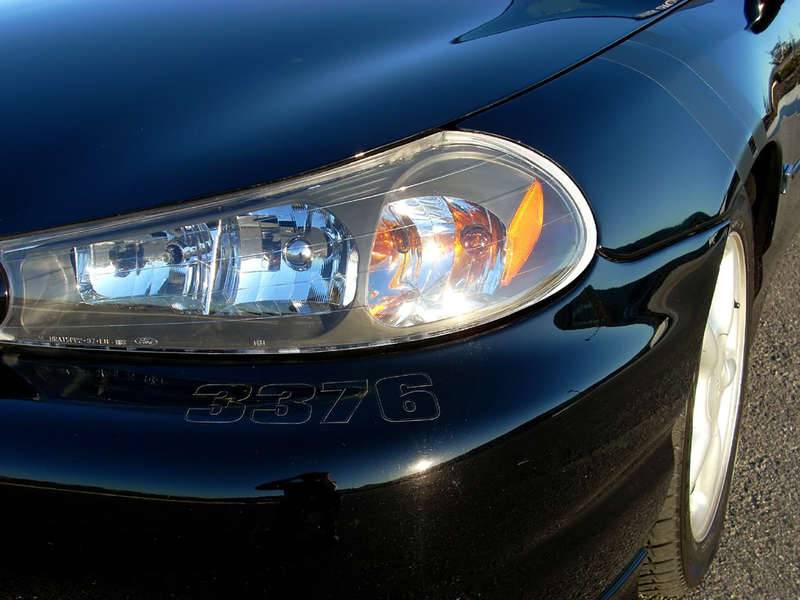

As for baking the lights. I wouldn't doubt that it can be done. I did it on my '98 CSVT and it was a p.i.t.a. Getting them apart isn't half as tough as getting a water proof seal back.
