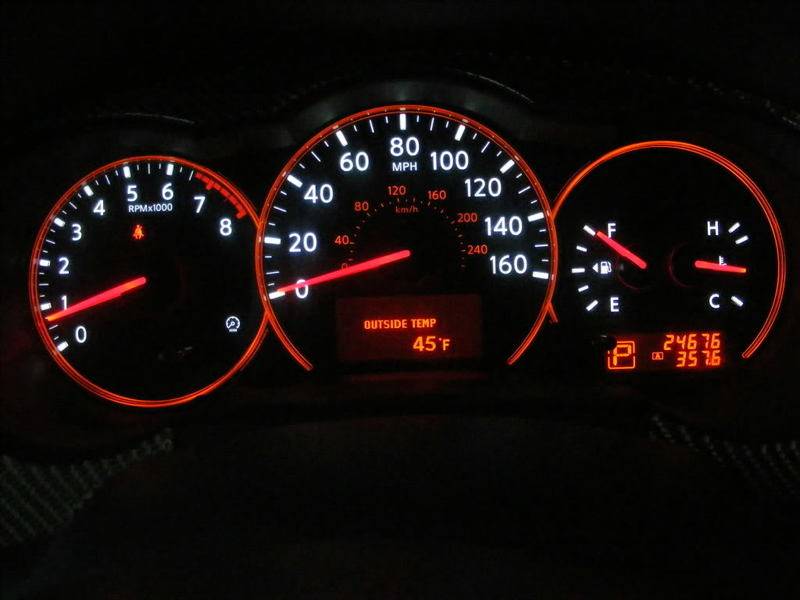

several of the lights can just be replaced with blue led bulbs.... but the intrument cluster "sheet" is coated with the green coloring.... it has to be sanded off... this is the case with a few other things in the car.... and if you sand too much... you ruin the actual numbers or picture.... trust me i found out the hard way..... the gear selector switch is actually 1 solid peice of plastic with the green color inside of it... so just changing the bulb does not work, I am actually in the process of making a new one from a mold of my oold one.....
