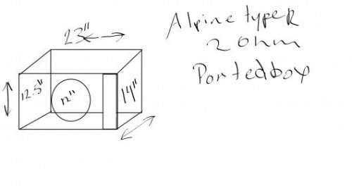

Hey I purchased a 2 ohm 1000 watt rms alpine type R and would like to build my own box. I would like the box closely tuned to the sub specs as possible but any type of ported box will do. I heard those ebay pre made LS boxes are garbage so i would like to replicate that box. show me your boxes if you want. heres a quick sketch i made on my surface pro using paint lol.. sub box.jpg

thats pretty much what alpine recommends for the proper box, if following their exact recommendation, it does need a fairly long port. since the port will have to make a 90* turn and also go down most of the back, I would make sure to put 45*s at the bend to keep turbulence down, or even just doing an AreoPort and not having any port noise.
the only change to their design I would do would be to make it a little taller, and there for you could make it a little shallower to take up less floor space.
also, if you have the OEM subs, you can remove them to be able to be able to fit an even taller box back there.
