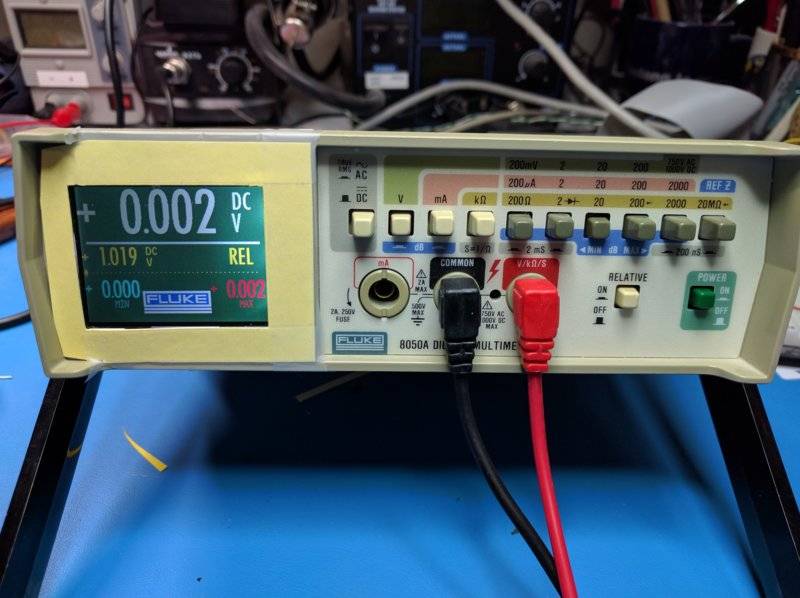

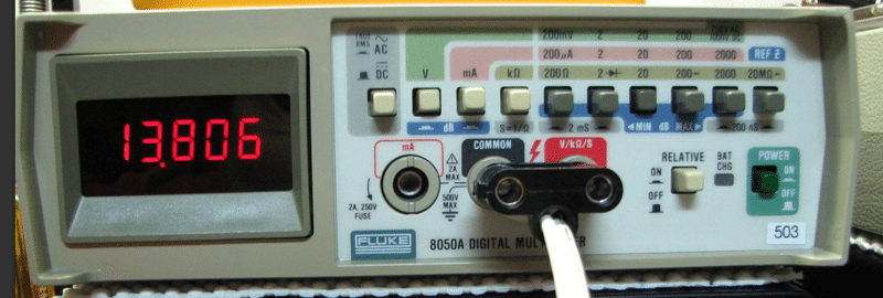

If the screen can be removed somebody could program a modern color LCD display with improved graphics and simply use an interpreter to display the inputs from the computer with better graphics.
The car does know it’s fuel economy at all times, but somebody decided to interpret it as a stupid bar. Because the info is there one could basically take data from the ECM and interpret it to a display screen.
In short, yes it “can” be done but I wouldn’t want to be the guy that undertakes the development.
If I had some nerdy friends I’d make a replacement full color pixel graphic LCD display for Town Cars and Mark VIII’s. It’s been done for other devices and even other cars before. Some Ben Heck stuff.
