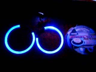

Thats correct. I plan on getting them apart and then getting some projectors from another car or place. Then use my dremel and cut some material off the back and mount them in and so some fabrications... I picked up 4 angel eye rings for 20 bucks from pepboys with LEDs already mounted inside the rings and i will see how they work, i put a 9 volt battery to one set of rings to see how they lit up and they look nice. As soon as i pick up a set of headlights i will install the angel eyes first and then post some pics then after i save up a few hundred dollers i will get the projectors and get to work on those. i am learning as i go along so we'll see what happens.
the only thing i have concern about at this moment is how long the leds will last in those angel eyes...

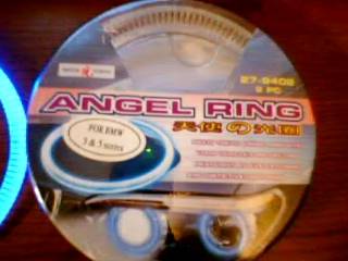

Here are some pics of the kit. I bought two kits, Each kit comes with two Rings. Kits were $10 each. They were made for BMW 3 and 5 series cars but it looks like they will be perfect for the LS. The kit that is lit up is being powered by a 9 volt. They should be even brighter with the 19volts from the car battery.

are they LED or CCFL?
well LEDs do not do well under continuously hot conditions. They thermally degenerate but iirc the MTBF, Mean Time Before Failure, is over 20k+ hours in temps under 100 degrees.

after replacing my LED halos for the thrid time - I went CCFL...
much brighter - can't even compare to LEDs....
