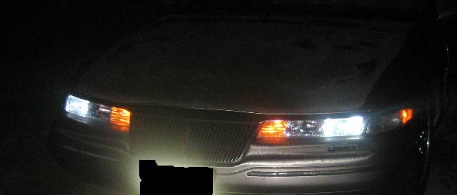

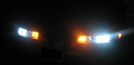

You can not see ... No beam ... No I tried these in my Low beam position hoping that the cooler temp of the LED lights would save the reflective backing of my housings. It is suggested that the LEDs be used as High Beams ... I'm going to try them there tonight just to take a look ... They do have a cool look when on but they don't project enough light.
Well this is what they look like.

Thanks for the pics. I didn't think they would beam very good. They may look good staring at them but looking good isn't going to help you see. I'll stick with the HID's. Mine also doesn't get driven at night much and the housings are crystal clear. Mine are about 4 years old. Being in the garage for the most part and not driving at night very often has kept them this way.If I do drive at night, I never even worry about bulb heat because the HID's hardly put out any at all. Nothing but super bright light.
Staring at them, they look blue but when behind the wheel, the light really looks more white. Hard to explain.
