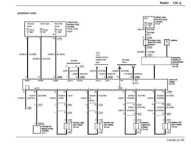

That's what the 04 LS wiring diagrams show.
The show the booster powered by the SSP relay in the trunk.
The SSP relay is controlled by the REM.
Maybe someone else with wiring diagrams could verify this too for the OP.

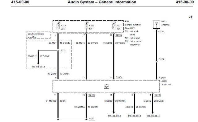

yeah - it's weird.
your Gen1 just shows a 'standard' antenna connection.
the Gen2 shows a 'hidden Antenna module'....
Same for the VSS questions you have - the Gen2 show one (probably since they had NAV as an option, then Gen1... nothing.

yep no antenna amp wire to hook up in either of my LS'es (1st gen and 2nd gen)
