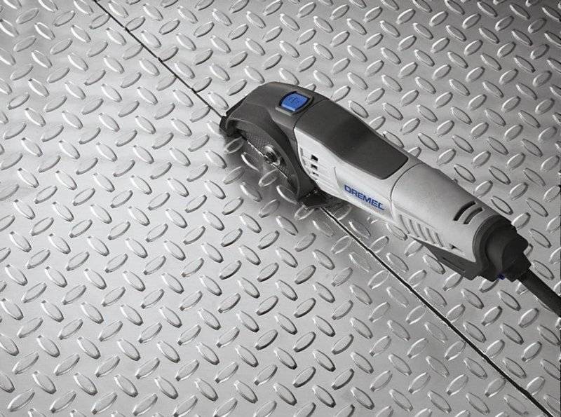

The most difficult aspect of getting the "life of the car" brackets off was getting the second cut to the bracket. The first was pretty simple and went relatively quickly with the Dremel. I could not get an angle for a the second cut. A "straight on" cutter would be ideal.
maybe something like this...but maybe smaller....

The pain was cutting the original bushings off with the bar in place. I went through a number of cut-off wheels.
