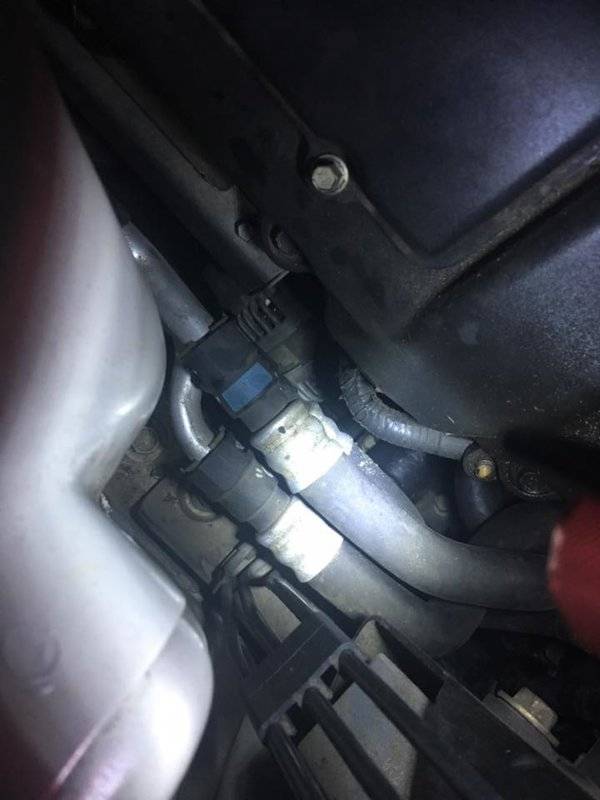

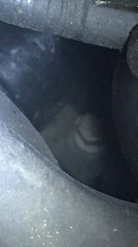

However, I just picked up a 24” 3/8” extension and found that I can get a socket on the bolt without moving the DCCV. (Attached is a picture). My DCCV has been replaced many times and I am wondering if there are different sized DCCVs.
Does this sound reasonable? Has anyone been able to replace the passenger side sway bar bushing without moving the DCCV?

The DCCVs are all the same size. I replaced my bushings on my 04 V8 without removing the DCCV.

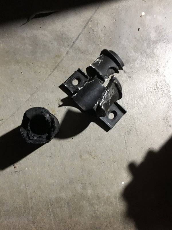

If I ever come across the "engineer" that designed these bushings and bracket that "last the life of the car", I'm gonna kick him in the nuts and when he bends over kick him in the shins. Getting to the bracket and undoing the bolts wasn't bad at all. I had some difficulty getting the air intake apart...the crankcase vent connector was particularly difficult. I am not sure how you guys got a straight cut at the bracket using a Dremel. I could only get to the outside half of the bracket, then my Dremel started to malfunction (more of an operator error). I used a regular drill to drill a series of holes across the other side.
Then having difficulty doing one cut I tried to pry the byatch off the bar...unsuccessfully. It was getting late so I just made sure I could get the new bushing, bracket, and collar on to make the car drive able. Then I was able to essentially cut most of the bushing out so I could maneuver the bracket around and make another cut and get it off.
On the bright side, the car is silent now. I had a suspicion that it was the driver's side bushing that was making most of the noise. I'll get to the passenger side, whenever....
I only have one picture of the mangled bracket and bushing.
