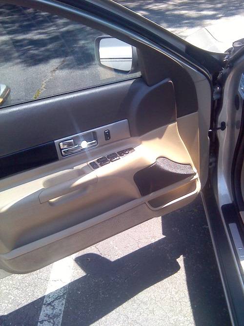

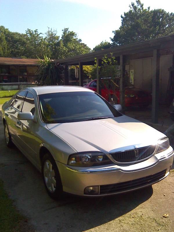

Hey Joe, no sign of leakage, the pressures are still dead on what they were when I charged it, well maybe 1 point higher, hard to tell after the little can of leak detector went in. And I did find that the "warmed" air only happens after the engine warms up, not before. Also the air diverter, or whatever it is called, that send air to the different locations, i.e. floor/vent/defrost, is SLOW to change positions, sometimes it take about 30 seconds or so to go from defroster to vent (A/C). but I did paint the speaker grills, and polished, buffed, wax, and detailed the LS this weekend.
