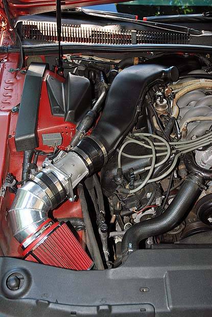

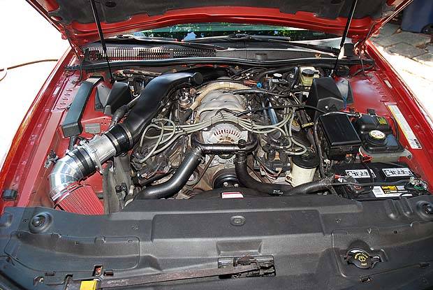

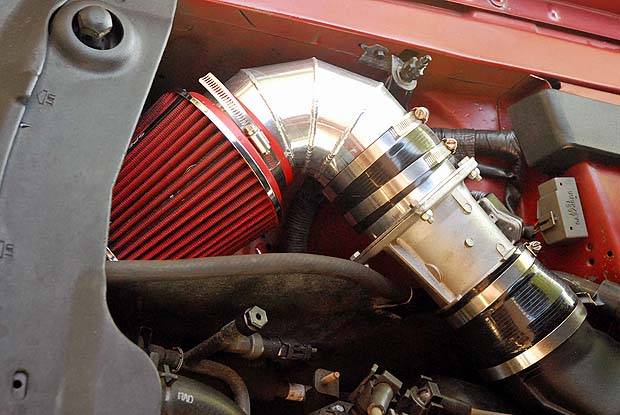

got all these items at Pepboys and only spent maybe $50-$60 bucks tops-I removed the silencer, and have the air filter blocked off with aluminum (hose is on edge of panel so I won't bleed to death when I'm in there working) so it draws from the hole where the silencer was located.
Threw in other photos of it since it's clean, LOVE MY MARK!
thanks, it runs great and I love the sound front and back-no mufflers, no intake silencers, great gas mileage, very quick and responsive, no codes (ever)...runs perfectly:p :I :I :rolleyes: :D

It looks like you got a 3in to 2.5in adapter for the back, an MAF to 4in cone adapter and a brightly colored 4in cone filter, along with a u bend 4in pipe.
Could you see what size that rear adapter is, if you don't remember, so I can go pick one up tomorrow. My car is not in my possession, currently being "serviced" by a pal because I'm busy as hell.
Okay, so mmtphoto
from the intake tube to the MAF is 4" on the intake tube side and 3.5" into the MAF-the one from the cone filter is 4" both sides-hope this helps
