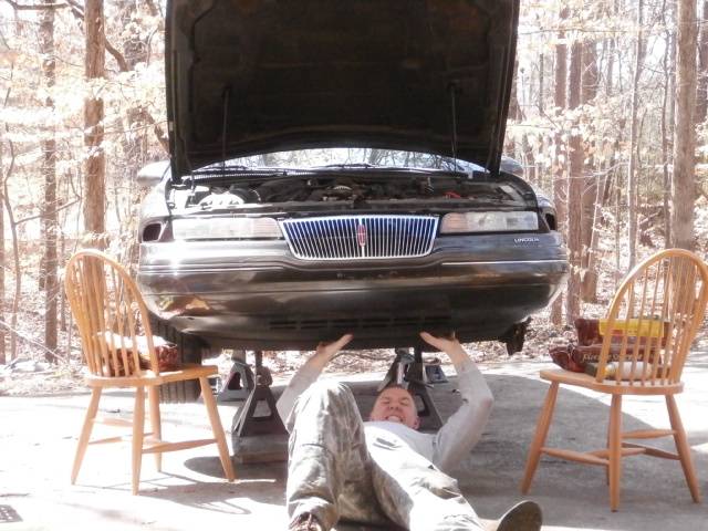

getting that bumper cover free from under the headlights was kind of a pain- thought for sure I'd break some plastic....it seemed like it would have been easier with the headlights removed?
in reinstalling the bumper cover, will removing headlights make it easier?
getting that bumper cover free from under the headlights was kind of pain....it seemed like it would have been easier with the headlights removed?
Yep that's where most of the time is usually spent getting those tabs to release and no it will not be easier with the headlights removed it will be the same IMO, just make sure you install it evenly so you don't tweak the grille(two people helps to put it back on evenly), the tabs should just slide in under the headlights.
well that's good, I started to remove the headlights to avoid breaking the tabs on the bumper but decided otherwise...i can't see how it's possible to remove the assembly WITHOUT breaking at least one of the grill's side connector brackets...I'll probably be doing it myself tomorrow...maybe using a jack will help?
this is the 2nd time r/r'ing the ofa gask...much better than the first time, but still not much fun
I find it easier to remove headlights prior to removing bumper..you can get your fingers underneath the header panel easier to unhook the bumper. If I were you I would just leave the two side screws out of the grille so when you're putting the bumper back on it won't stress the grille at all, 5 screws at the bottom is plenty to hold it in, along with the bracket on the backside also. I've removed two bumpers from junk yard cars and the bumper on my own car. I've got it down to a science practically, but let me tell you, if the bumper twists AT ALL that grille is going to crack, so take your time.
I've had mine off a few times also, could probably r&r it blind folded:p
But yes I highly suggest a second set of hands when reinstalling it to prevent what Kevin mentioned about the bumper twisting.
I'll probably try to install it myself, but with a 'dead man'...(temporary vertical support)...a box or crate, cardboard....open to suggestions on how to do it without breaking the new/used grille
Put a box on one side to hold it up kinda close to as high as it needs to be. You're not going to break the grille unless you really twist it. Once you have one side on and a screw in, get the other side on and a screw in and then go to bolting everything down.
easy peasy...git 'er done!

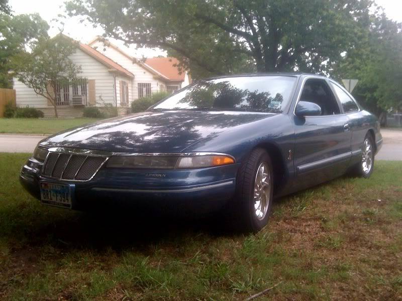

Anyone has any idea what I could do with my grill on my Mark?
Unfortinetly my car isn't black, otherwise I would most definetly paint it black amongs all other chrome trim.
A green car, black grille/chrome trim. Must be the worst color combination ever.
Anyone has any ideas?
