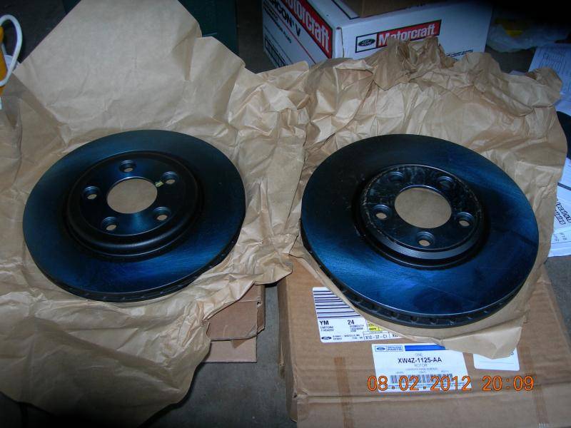

Picked up rotors today from dealer. Total with Perks discount card was $299 OTD. First thing I noticed was "made in brazil". :( Took them home, opened up the box, and noticed that the vane section, and non contact surfaces of the hat were painted black.
These are starting to look alot like Fremax rotors, which are supplied by Beck/Arnley. Never seen a factory rotor with painted black centers and edges. At this point I am suspect. Thinking about ordering the Beck/Arnley Jag 320's + stock size rears, and seeing what I get, as far as quality and country of origin. I will also compare rotor configuration, and thickness of disc surfaces, compared to vane section. If this all pans out the way I think it will, I can have the big brakes, including the caliper brackets for $287.

Took a close look on the back of these rotors. There is a bunch of info, but the casting is rough in this area. It is hard to read, but I was able to make out a "Ford" insignia, and also "Varga". :shifty: So it seems these are exactly what you describe above. ^^^ So are Varga rotors any good? Are these keepers, or should I pursue the Beck/Arnleys. I can return either, but for a nominal shipping fee on the B/A. I might be able to purchase 1 B/A rotor from a local parts store, and compare the markings. Then if that seems the better road, purchase the rest elsewhere. Maybe this is all worth it, just for the education.
---Mike---
These are the original equipment Ford rotors made by Varga -> Lucas -> TRW of Brazil. TRW is currently the parent company. If they have the Ford insignia then they were made in the original tooling that Ford paid for. The insignia is part of the contract with suppliers.
We used OE TRW rotors for our tests (where TRW was the supplier) that had the black paint. That's normal. It all depends what the vehicle manufacturer specifies.
