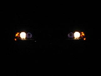

Tell me what you think, as well as a low beam suggestion to match the dde kit. I prefer the look of 2 rings over 4, it makes people wonder what car it is because 2 rings aren't found on bmw or most other angel eye conversions. The halos are meant for night and dawn/dusk use, and not visible during full sun.

Looks Good to me.
Its different, but at night you wouldn't really be able to tell you didn't have four unless you were driving around with your headlights off, would you?

Did it all myself. It wasn't hard at all, thanks to the help of eL eS and quik LS. Got the idea of using electroluminescent wire from a company in england. The cost of LED rings without the problems.
