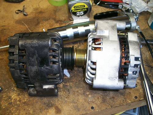

FWIW, the DB Electrical ones come with a small pulley but still did not operate properly. See below:
My analysis back then showed the same behavior:
http://www.lincolnvscadillac.com/showthread.php?t=70385
I think it has more to do with the PCM control than just the RPM, unless they modified/replaced the regulator to ignore the PCM control. Because once you put a little throttle into it (or the IAC has it idling high) the engine is making more power and thus can have the alternator loaded higher.
The only vaguely similar thing I can think of is 1 wire alternators. But those have a turn-on minimum RPM, usually around 1,000-ish. Once turned on, they don't turn off until the engine completely stops.

I too have a never installed DB. Heck of a pricey paper weight....LOL. Replacing the defective alternator Tuesday along with putting on a set of front rotors and a pair of Napa Ceramic pads.
Now I am thinking. I wonder what parts I could use from the DB inside of the used Motorcraft so that I have somewhat of a new alternator? The more I look at the DB, the more I need to figure out how to get some of my money back out of it.
Thoughts?
Was that cracked vent in the casing an install "mother F****" or a "piece of sh!!" removal after failure? I threw the original factory against a concrete wall after my first removal. It had similar broken fins like you do lol.
Fingers are crossed here! I hope it works out.
Lou's alternator always worked just fine. No idea how he got so lucky! His must have been one of the first ones made.
The broken fin came that way out of the box........
