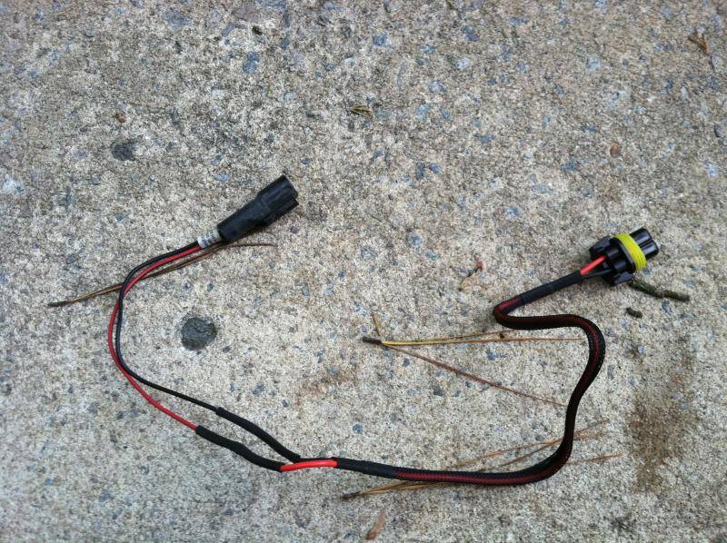

While i believe that what Sapperfire said was perfectly reasonable (especially for someone that's been a member here as long as you have), I'll tell you what I did for my 97....
Unplug your stock ballasts. Cut off the plugs that plug in down by the base of the radiator off of the ballasts and solder them to the harness that comes with your HID kit like I have pictured below. Cut off as much as you can so that you're sure to have enough length.
Do this for BOTH sides, don't just use one.
Now you can just plug and play. If you get a quality HID kit, you won't get the lamp out warning. My DDM kit has worked flawlessly for 2-3 years now. Always lighting on the first try, and no warnings.
