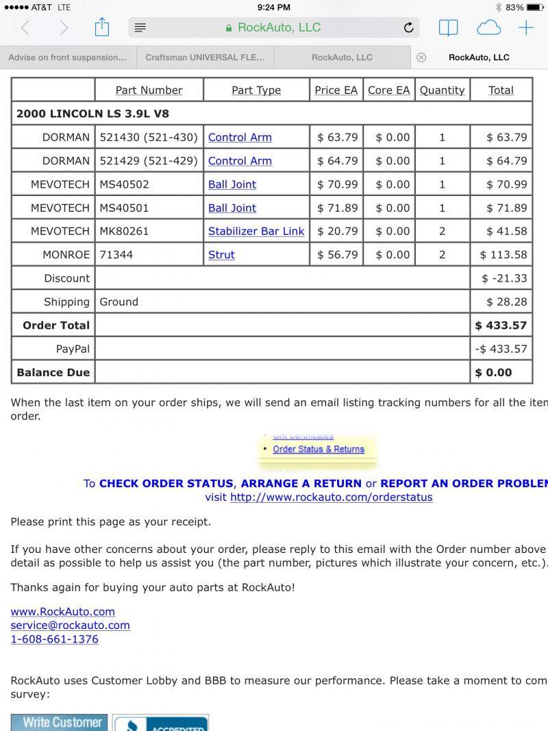

I got all my parts from rock auto, except for the outer tie rods, rotors and pads. Got the tie rods from advance auto after pulling everything apart and realizing they needed replacing. From rock auto it was $433.xx shipped. I'll probably catch hell from posting the following picture because of the brand names, but whatever......
Where it says ball joint, those are the knuckles with the ball joints. I googled for a discount code. I think it was 5% IIRC.
