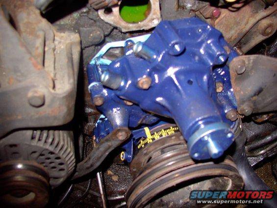

Most times you'll have to clean off and paint the balancer to see the timing marks or you can use Summit's or Ford Racing's timing tape.

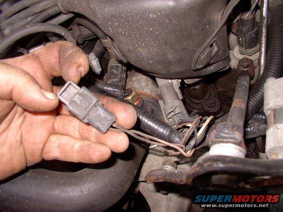

I did this;
Other than that you want to warm it up and pull out the SPOUT valve to slow the timing down to the point you can read it.
The factory 10 or 8 degrees just isn't getting you the free mileage and performance that a 5.0 litre can give. I've tuned four 302s in 4 completely different vehicles and they all loved 13.5 degrees using plain old 87 octane.
This really woke them up and improved both throttle response and mileage noticeably. Just remember to put the SPOUT valve back in afterwards.

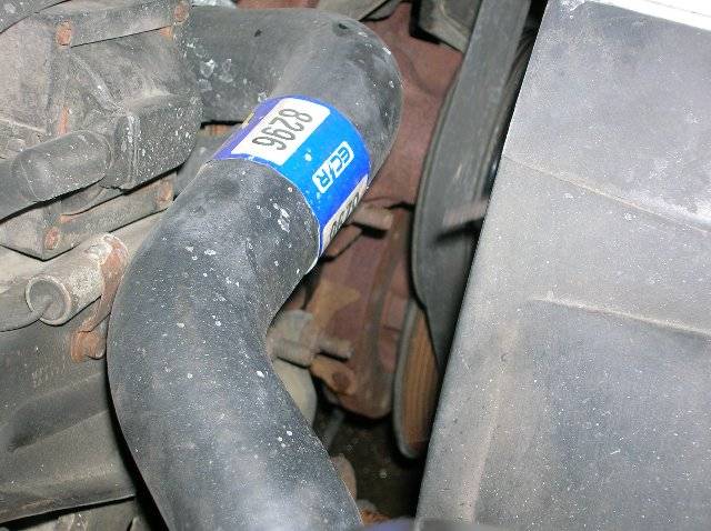

Heres what mine looks like... The part that is weird is the big notch on the pulley never went by the needle when the timing strobe kicked on... I had everything hooked up right with the clamp over the #1 plug wire, and i could only see the notch going by when i turned my flashlight on...
That's because your SPOUT valve was still connected.
This would ensure the timing would be so advanced the mark wouldn't even show up under the timing light.

I dragged my @$$ outside and snapped you a photo of the much fabled SPOUT valve;
Think you can find it ?
