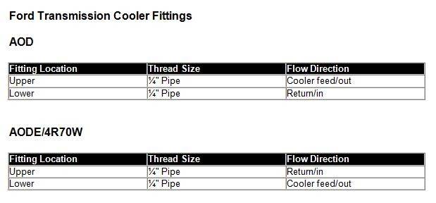

TCI has a tech page which shows the return and feed line positions for various transmissions HERE. Most have the return at the top, but not all.
I've attached an excerpt that shows the lines switched between different Ford transmissions also.
And the Gen 2 return line at the radiator is the upper line. ;) Makes sense if you think about it a bit, the transmission fluid enters the radiator where the engine coolant is at it's lowest temp.
Don't know for sure about the Gen 1.
