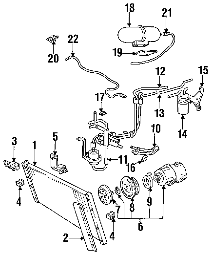

Ok, so they are saying its the high side pressure line from the condenser to the compressor. I found an image of the parts at http://www.tascaparts.com, but they are hard to figure out. Here is the image they give
I know what the high side line looks like. I was just wondering what "yours" looked like, as far as rust was concerned but if you smelled it and the pressure dropped just about as fast as you added, then yes, you have a bad leak and is most likely where they say it's rusted. Could also be in other places too, along with the rusted out high pressure line.
Would #13 be that high pressure hose. I found the part at tasca ford, but don't want to waste $70 on it if wrong. It says hose cond to evaporator though so I am not sure.

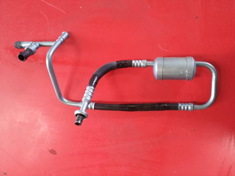

Is the filter right by the a/c comp? If so mine and that line that swoops down then into the filter is cruuuuuuuuuuuusty.

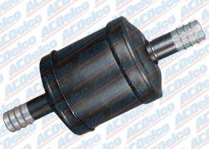

There lots of places that will make lines, some have new ends some will use your old ones, in either case for that line your talking about with the muffler, the muffler doesnt have to be there, its just for noise.
Also, that line with the muffler cant be flushed as it is a stacked plate design inside and you wont get all the stuff out.
It is part of the line, you gotta replace the whole thing, I've got a couple spare (nearly everything)
Hook him up Sapper, you live in a rust free area and w/e you have "has" to be better than what he has currently. His line with the muffler/filter and all are rusted so bad that no 134a can be added at all. If you could send him a line like you have pictured, all he would need is the o-rings and then have it installed and then a vacuum pulled and then filled properly. He should be set after that.
markviii96, let him ship you the whole line and all. You'll be a lot better off going that route. Don't use a rusted out high pressure line. It's just asking for trouble or well, another leak when the line bursts. Of course I don't know what Sapper wants for one of them but I suppose you two could work that out in a PM.
