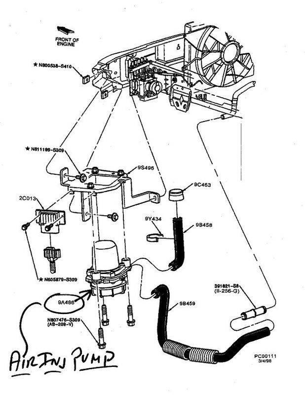

Just because I'm in a good mood and bored, I loaded the baby spoon to the hilt and searched for you.
ABS valve body/pump just to the left of the radiator fan (the big round thing)
