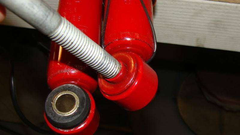

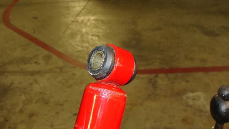

Jamie, Where did you get the bushings? Part #? Koni lower bushings are junk, and I want to replace them.
Thanks!
i will see if i can find out, i cannot remember i have a huge zip lock bag filled with various shock bushings and they were in it with new sleeves. i will see if the paper tag is still in the bag with any numbers on it, i honestly cannot remember where they came from, but i knew saving them would be worth it some day!!!!
are your not he bushing guy cant you just make your own
LOL!:D
Delrin isn't the right material for shock bushings, they need to have some give to them.
Poly is better suited to being molded, not machined.
If I have to, I'll get a hold of some poly and make some, but I'd rather not reinvent the wheel. ;)
