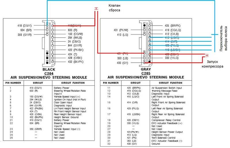

Blue connection to open the desired bag to pump, red to pump or inflate (inflate schematics in the middle, pump - on the right).
Manual leveling will not be as perfect as automatic in any way.
I prefer thinking of "manual mode" as an emergency feature.
