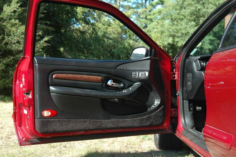

I went the other way and installed 97 panels on to my 95 doors. You will have to move the handle to a more downward angle and the only plugs that will work are the trunk, gas door and I believe the speakers.
Gen I's have a ground wire for just about every circuit. Allot of the wires are the same colors in both years but will have to have the gen I pig tails spliced in and the window switches are wired a little different.
If you have a 97 car I would suggest staying with a 97 door panel. No one here will disagree that the Gen II's have a better interior anyway. Several member including me, have a stock pile of them.

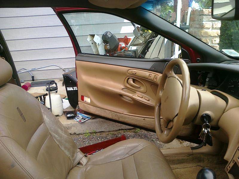

Before:
After:
Fantastic information guys! looks like I maybe sporting an opal door for a bit. Anything is better then watching people swerve out of my way when they see my door damage thinking IM the crazy one who caused it lol. Its just like having sirens on.
