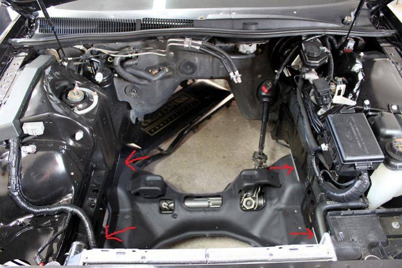

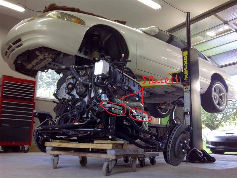

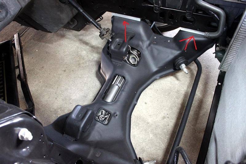

A 97/98 engine will drop right in and work with a few small tweaks, were it will get you is the hood clearance. You might be able to get away with a stock hood if you add spacers on the K member to lower the engine down.
You don't want to space the cradle, that throws the front wheel alignment off and adds extra stress to all of the suspension components
