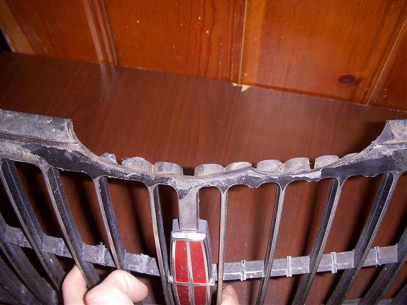

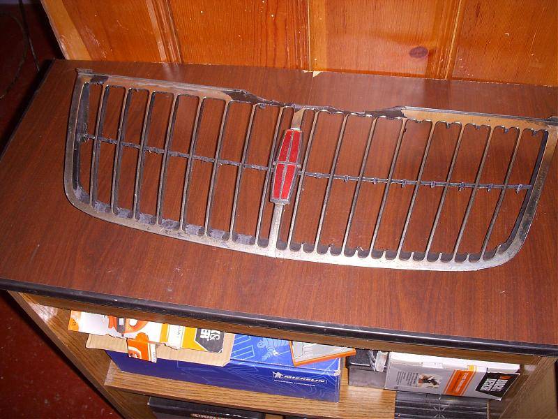

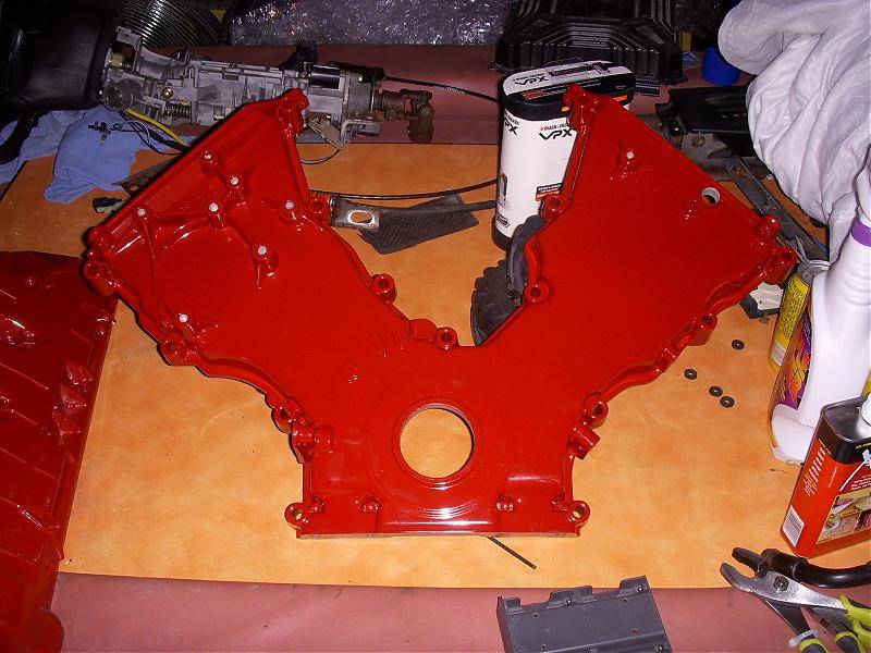

Ere are the pics of the grill, and timing cover. There is also two fins that are broken that i will need to fix

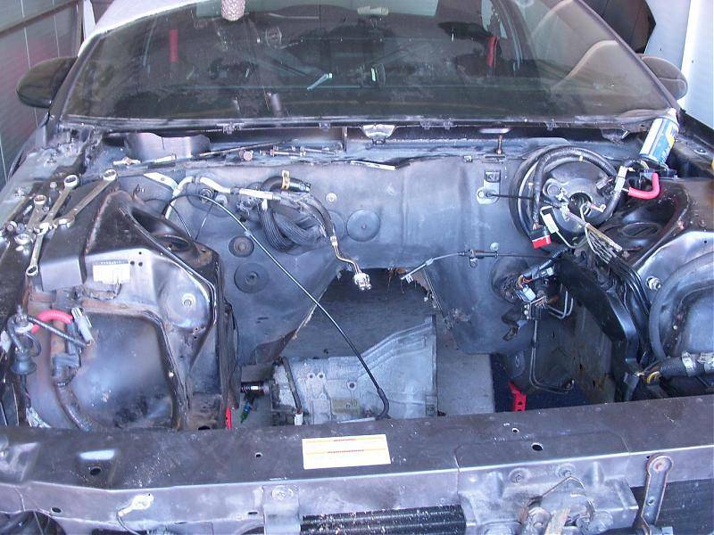

Well, i finally got my motor dropped, tranny is out, is there anything worth saving on this tranny, the one way bearing is supposedly out, does the mlps work on all the trannies, cause the one that is on there is brand new, also is the tail shaft worth keeping, or does all 4r70w have the same lenght, also got my gas tank taken apart, but have to wait for it to get warmer before i can clean out the inside.
not sure but dont you need the internal electrics out of the trans is you decide to go to a newer style, might be worth holding onto.
.........i dunno i just thought someone said if you are going with a 98'ish trans to just swap the electronics. hit up nolimit95 and see what he did
When nolimit swapped his in he did it based on Krackers article... swapped all the electronics and reused his 94 harness...
