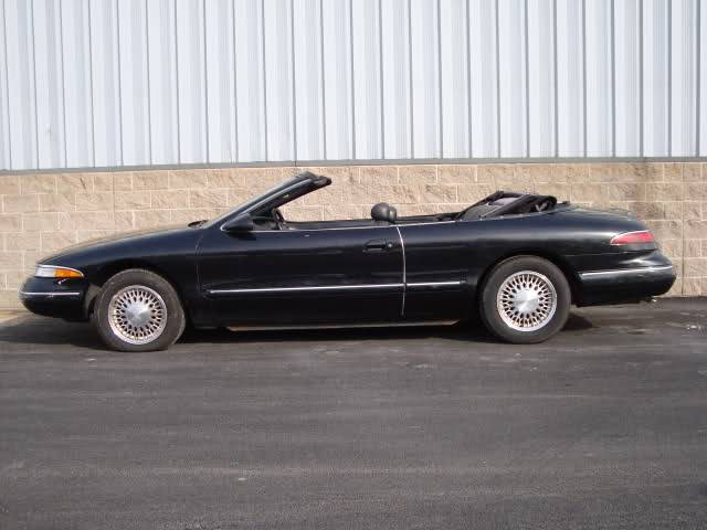

As of 1-3-09 The air ride is back to normal. I swapped in a newish compressor, drivers air strut, and compressor relay, and everything is good to go as far as the air ride is concerned. Here is a pic I took of it today.

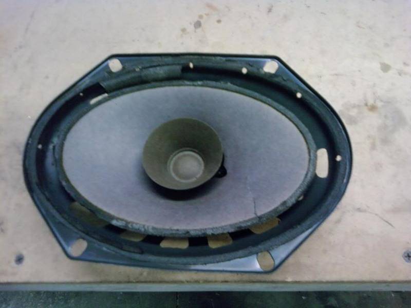

In your other thread you said that you had a blown rear speaker. 2 of my 94's sounded like they were blown, but it was just the rotted foam gasket between the grille and trim peice. The speaker in the green car was loose too. I replaced the gaskets with a peice of black T shirt, cut to the same shape as the gasket.
If the speaker sounds like its rattling with the bass, just hold your hand on the grill, if it goes away, that's all it is.

you said its not a jbl system, its the 4 speaker premium sound, the speakers are junk, i'll put money on it, this is what they look like, this is what happens to all the premium sound speakers...
Holy crap! Foam speaker surrounds? That was the dumbest idea that speaker manufacturers ever had. I was hoping by 94 that they figured that out.
I've seen many old (and expensive) home speakers destroyed like that.
The old Bose 901's were one of the first ones I've seen destroyed like that. To fix them, you would have to replace 9 drivers on each speaker (I think it was 9).:mad:
