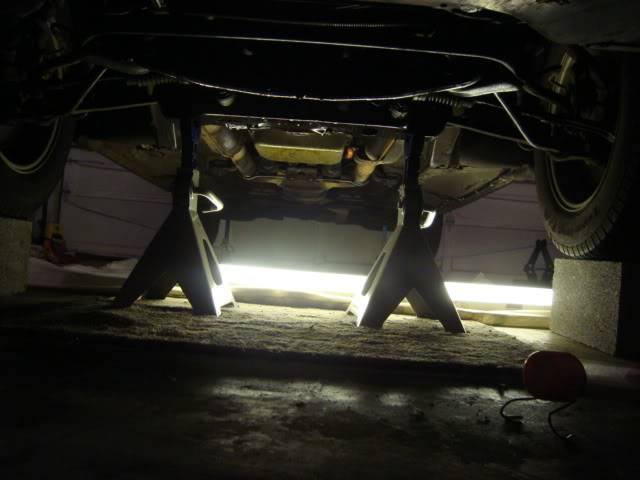

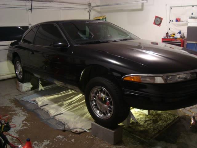

don't get under the car without jack-stands. don't want it falling on you. i usually put the tires under the car so if something happens the tires won't let the car squish you.
You have that phobia too?
I have to have a jack, jack stand(s) and I might slide a tire under the edge too and I make sure a phone goes under the car with me. Ya never know about them freak accidents. You should have seen how I had the 94 jacked up when I changed transmissions lol. Jack, two 4 ton stands, two 2 ton stands and all 4 tires were on top of blocks. :) It wasn't gonna fall.
Good setup there, I don't think it's paranoid at all. What a lot of people describe as a "freak accident" isn't really that uncommon. And much as I love my 4,000 pound Mark, I have no desire to be crushed to death by it.

Something I've learned over the years: If you don't let the car slam to the ground after installing the shocks, it won't do that. The last time I changed out my front shocks I let the front end down until it was jut a hair under normal ride height. Started the engine and the springs pumped up with no problems. You don't want the weight of the whole front end on the air springs when the compressor kicks in to pump them up.
As far as all the precautions y'all take about jacking up a car, one of my best friends died under his Camaro because he had it jacked up with some firewood holding the car up. He was pulling out the transmission to install a transmission I SOLD HIM out of my recovered theft victim '70 Chevelle.
His girlfriend found him pinned under the car, called 911, myself & another friend, and was absolutely hysterical. I don't want to ever find another person like that - pulled out from under a car with his arms crossed over his chest like he was trying to save himself.
By all means, take all the precautions you want, don't let ppl talk you out of them, and don't take shortcuts! :thumbsup:
