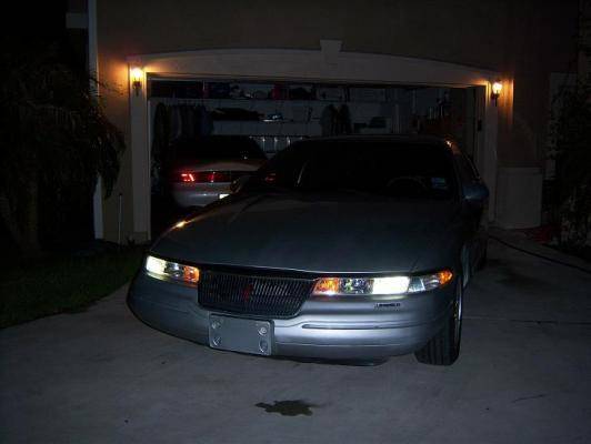

White LED Conversion
I love that color combo, time to find a rear lsc bumper now..maybe add some chrome 10 spokes..looks good otherwise rattle can or not

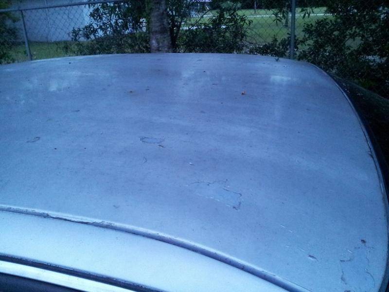

Now my summer project has been to paint my entire car and what lead to the progress thread. When I bought the car back in 2007, it had been recently painted. With my unskilled eye back then (I was 15) I thought ohhh new paint! I now look back and I am amazed how much I've learned since. All those failed projects have taught me a lot though. So now I'm going to practice painting... hoping it isn't as big of a fail as when I painted the car back in 09 after the crash. I have done a lot of different stuff but paint was something I couldn't do right. The paint may look okay in pictures but if you look close up it's just plain broke... yes I just called paint broke. So my logic was I can't possibly make it look any worse than it looks now so let's learn painting!!

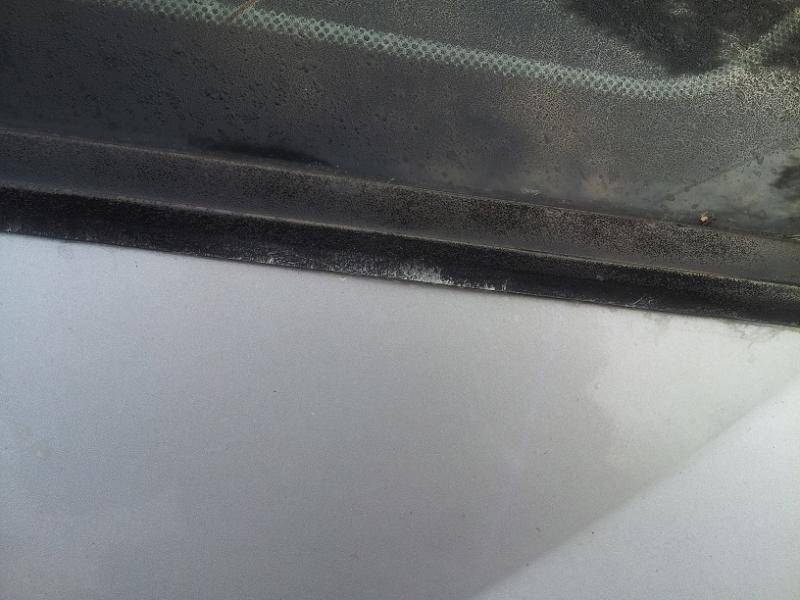

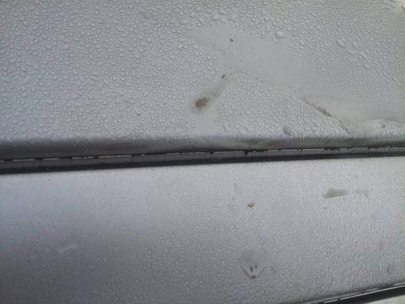

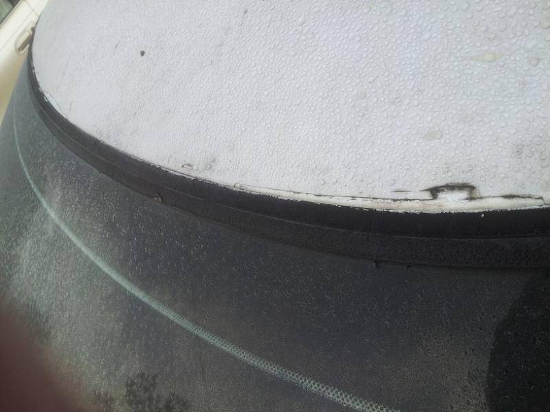

These pictures just show some of the problems. You can see in the exhaust pictures posted before how bad the paint was. The paint I did with aerosol cans yes wasn't glossy but it was holding up better and I painted them off the car...

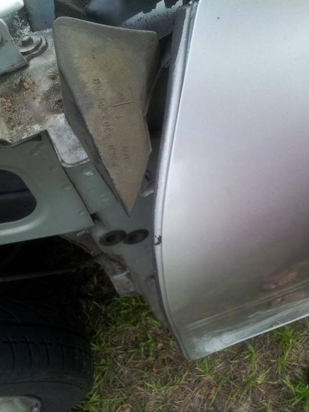

These only show part of the problems. Paint is all over the rubber trim. It's on the rubber gasket of the windshields, trim, door handles... it's chipping/bubbling. I think I can do better than this...

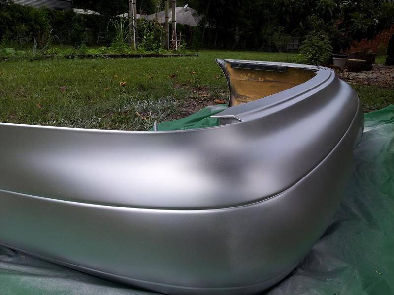

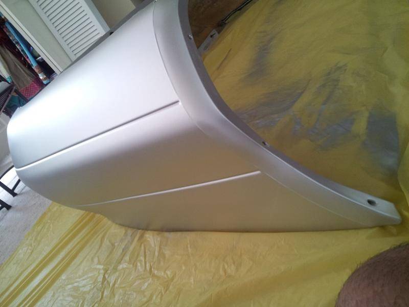

Decided my base coat color. I wanted to continue with silver but I wanted something more metallic and less blueish. This was only testing guys. I will not be painting them on the ground and I did cover the bolts with tape. My goal is to have a better paint job in my budget. I don't want to be spending too much. And did I mention I don't have a garage? I will be painting the car outside and any panels I can remove will be painted in my small shed.

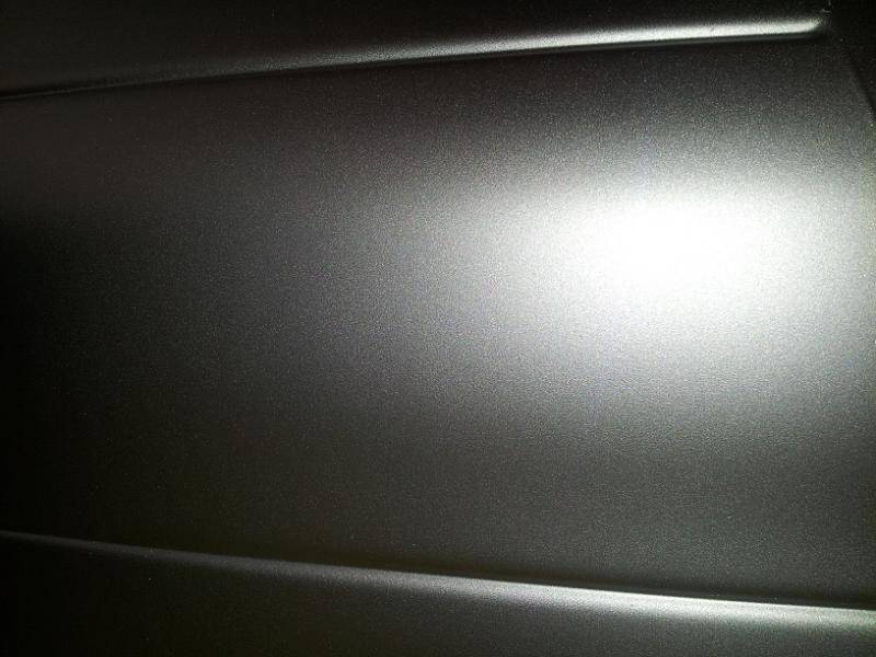

Why clear in a can or premixed clear will never work...
Most people would probably encourage that after sand and buffing it would shine but with little research I found clear is quite different than normal paint and isn't just sprayed on from a can.
My old bumper
Proper clear coat test on my already painted bumper... still testing how to paint.
Comparison
