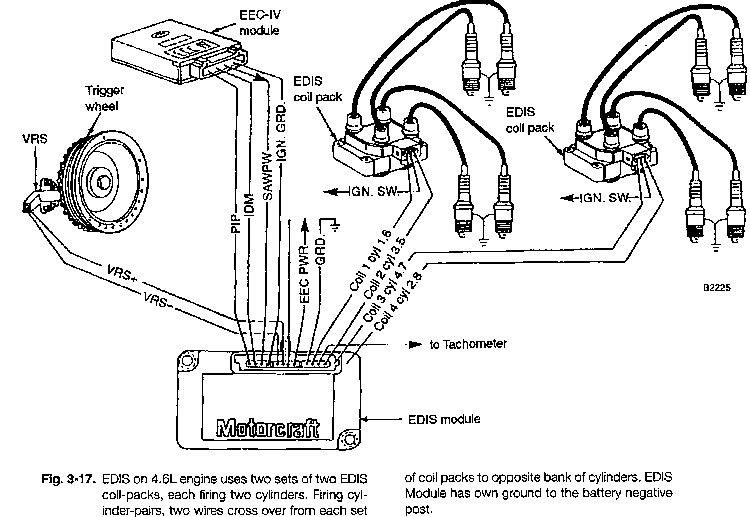

This might help explain it. With the EDIS system, there IS no cam sensor...

Who would like to help me EAT this Crow?...There IS a cam sensor with the EEC IV/EDIS 8 system...:slam
