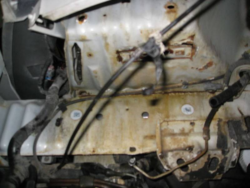

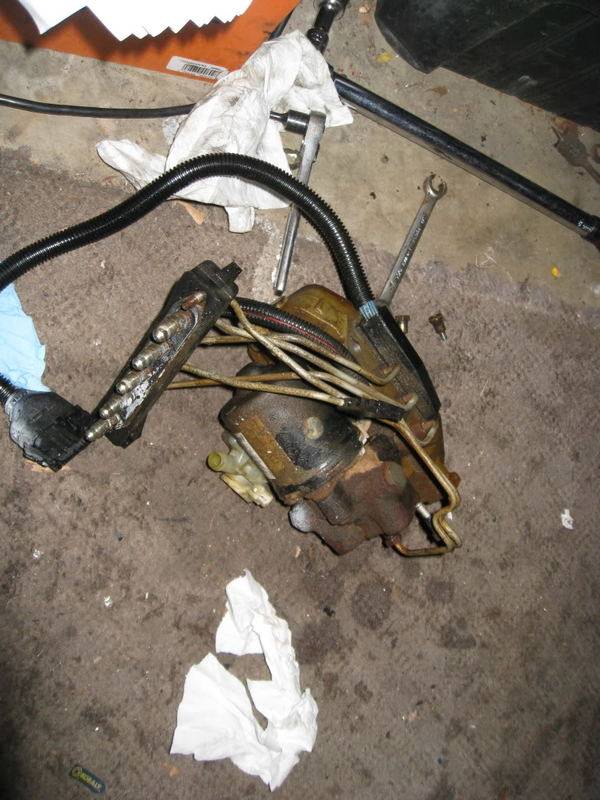

its all in that left front fender right next to each other. the pump is bolted to the valve body.
pump and valve body.
they sit up in here.

The code 23 is the code for a valve in the hydraulic control unit(HCU). The only fix is to replace the unit(with or without the pump), but the HCU must be bled afterwards. I have the gizmo tool(adapter) for this you can borrow if you'd like. Without bleeding the air out of the HCU, it would be really hard to get ALL the air out by conventional bleeding methods.
