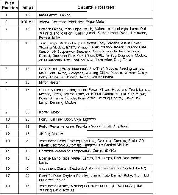

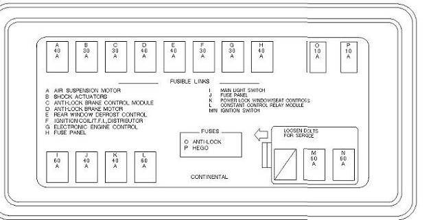

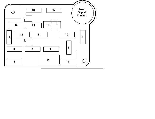

RECENTLY PURCHASED A '93 CONTINENTAL. NO OWNER'S MANUAL. CAN ANYONE PROVIDE FUSE PANEL LAYOUT INFORMATION, PLEASE. OR, BETTER YET, ANYONE KNOW WHERE I CAN GET AN OWNER'S MANUAL ('90 - '94 CONTINENTAL)? cHEAP! :feedback:
check ebay for the factory manaul, and i think helminc.com for the deal manual. If you want a cheap knockoff there is always chiltons and haynes. The chilton manual has the fuse box description. I got mine at murrays. Best of Luckk
Big Joe
This should work...
Fuse diagram
Thanks, driller - that should help a lot. I wonder why they always show the signal light flasher in the fuse panel, when it often isn't (as in my case).
