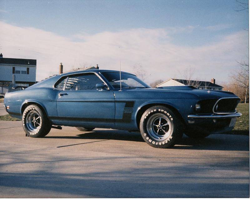

I don't know off hand, but here try mine (one I did own). Personally I think you would be further ahead going with a Modular motor because of the ease of adaption as well as the tuneability. Just my 2 cents.
That is one of the most beautiful cars I've ever seen.
