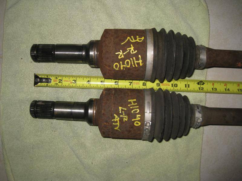

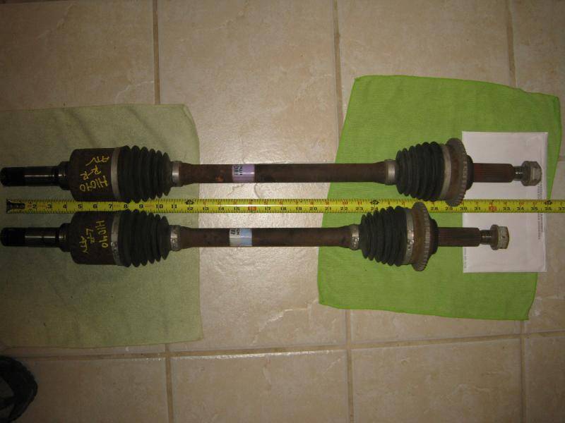

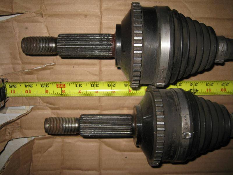

Right after I posted, the doorbell rang and Fed Ex dropped off the pair of 06 LS Axles I purchased last week. I will tear one apart and record the dimensions ASAP.

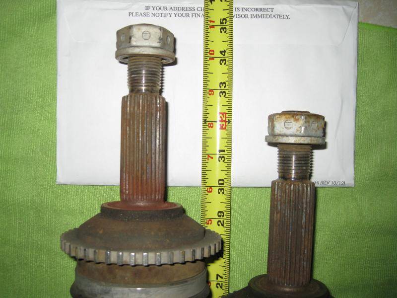

These are Gen 2 LS axles. First thing to note is one is shorter than the other by almost 3". This goes to show how different the Gen 2 carrier is than the Gen 1.
(Note: Reference to Gen 2 LSD threads)
I counted the splines on both ends of the half shaft and as I believed, they are both 28 spline!

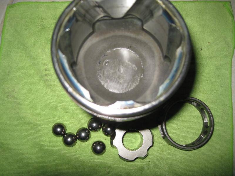

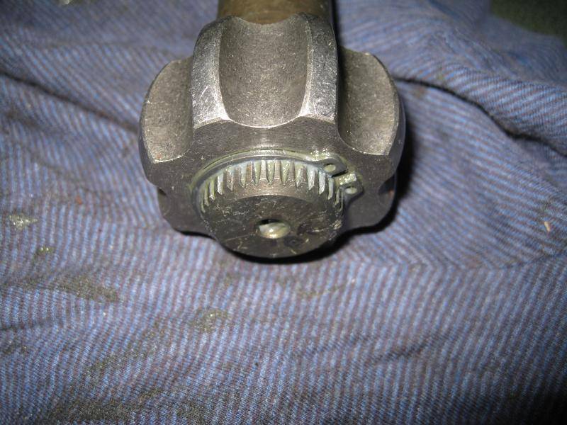

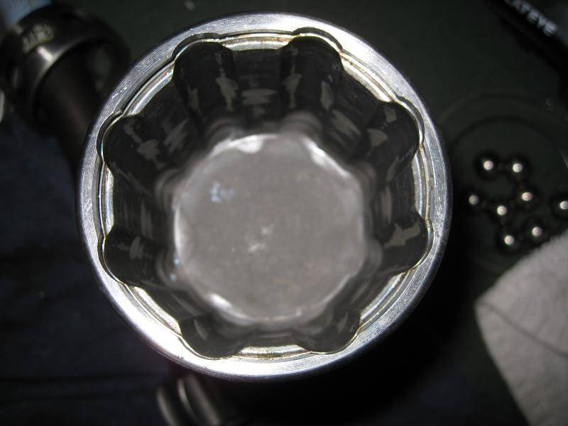

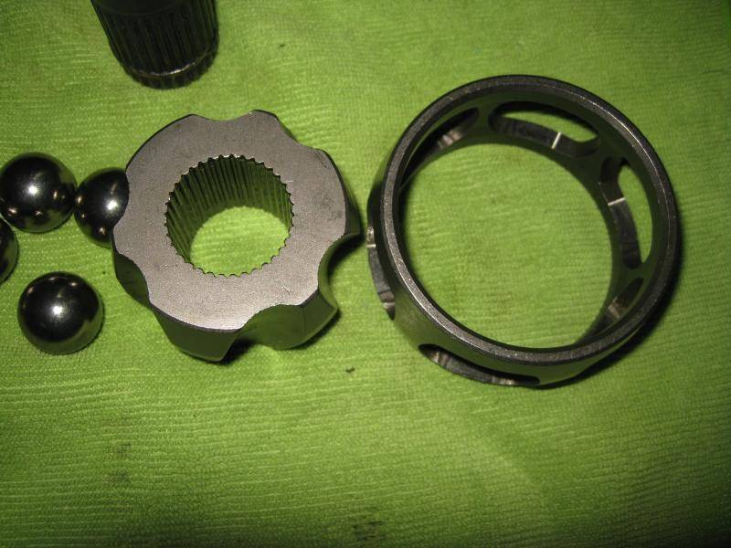

I took apart the 06 LS inner CV joint and was pleased to find that it is not a tripod bearing, but a true 8 bearing Rzeppa CV joint. This design CV joint should take way more that 500HP and lots of torque!
I was also pleased to find that the inner race and axle has 35 splines, rather than 33.

The half-shaft on the LS CV joints is actually tapered down in the center. You might be able to have just a custom half shaft made that is the same diameter for the whole length. That would also add some strength. Also possible the half-shaft out of an explorer (cobra would be too short i'm guessing) might fit assuming it's any thicker. This is where I'd go to an autoparts store, pull a CV joint down, and measure the compressed length and half-shaft diameter before buying a used one to tear down. If the length is wildly off or the diameter is smaller then you can just skip buying one for the half-shaft. If the diameter is also bigger then the splined end then you can skip it since it won't fit your inner joint.

It is a 8 bearing Rzeppa VC joint. I haven't been able to figure out how to get it apart yet. (I can't see any retainers, and I don't want to pound on it yet)
The outer CV joint has no linear travel. (Not needed, versus the inner CV joint)

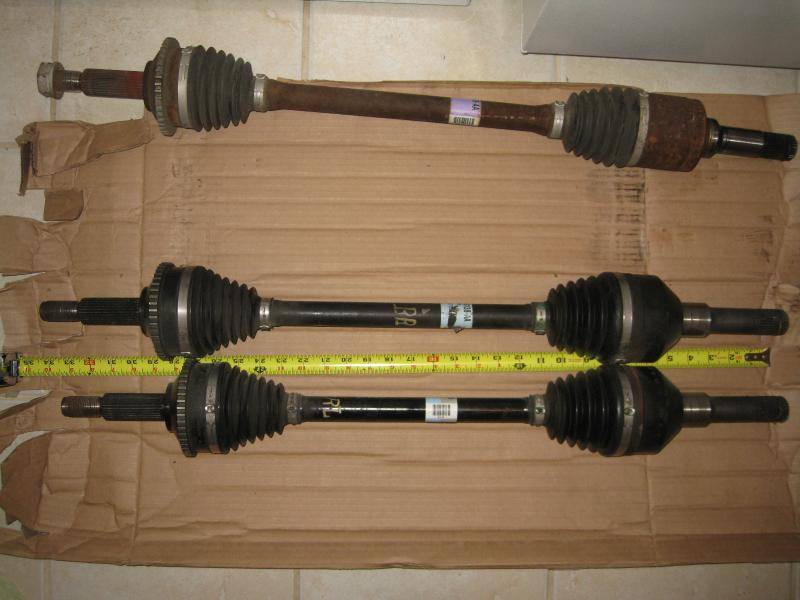

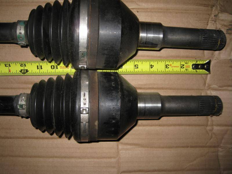

The set of 2001 S-type axles arrived today. I am amazed how different they are from the 06 LS axles. I will take one apart ASAP.
- First thing that stands out is that the inner axle stub for the Gen 1 carrier is longer than on the Gen 2 inner axle stubs. Show how much different the Gen 1 and Gen 2 carrier housings are.
- Next I see that the LH and RH axles are unequal lengths, but not as pronounced as the 06LS axles. about 1-1/2"
- The CV joint housings are significantly larger on the Gen 1 4.2L axles than on the Gen 2. (100mm OD versus 85mm)
- The axles shafts are a smaller OD on Gen 1 than Gen 2. 27.5mm versus 29mm

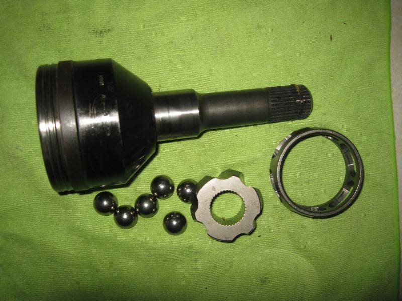

I took apart the inner CV joint on the 2000 S-type Axles. This assembly is larger than the 06 LS inner hub. There are 6 bearings rather than 8. The spline count on the axle is 36 teeth. (Even though the main diameter of the axle is smaller, the splined area is slightly larger than on the 06 LS axle.
When I get a chance, I'll post the 2 next to each other.

Question is: Which inner CV flange is stronger? Larger with 6 balls or Smaller OD with 8 balls...

I'd say the 6-bearing joint cause of the angled races. It would distribute the stress more evenly over the cup, or at least that's what I think. Plus more surface area from the larger bearings would help as well. Just how much stronger I wouldn't even have a clue.
>I'd say the 6-bearing joint cause of the angled races. It would distribute the stress more evenly over the cup, or at least that's what I think. Plus more surface area from the larger bearings would help as well. Just how much stronger I wouldn't even have a clue.<
Not sure I completely agree with you. Wouldn't 8 ball bearings distribute the load more evenly around the joint?
Assuming each ball bearing has close to the same contact patch area, I tend to think that 8 contact points would be better than 6 to distribute the torque plus perhaps transmit a higher load overall.
But on the other hand, the larger inner joint is a crosstrack style plunging CV joint where the 6 ball follow a "S" shape on the inner race and housing. The 8 ball smaller CV joint on the 06LS axle is a standard ball plunging style CV joint. (06LS also has more travel)
Therefore I am on the fence concerning which is stronger overall.

The GEN II axles won't fit into an 8.8 housing, look at your last picture of the axles, you'll have to get that collar on the housing side machined down so the axle will slide in all the way.

Thank you for the input, but we already know that the axles are not interchangeable. My goal is to use a 31 spline inboard CV joint stub in my Mark 8 carrier with a Torson T-2R LSD. I need a carrier and axles that will handle 600HP.
This part of the discussion is about all the differences between the Gen 1 and Gen 2 half-shaft axle assemblies as a discovery process regarding what the parts actually look like visually and dimensionally.
I would imagine the larger diameter makes the angular force on the bearings more perpendicular to the axis of rotation. Meaning more force is pushing to the side of the bearing as opposed to trying to push the bearing up. With any bearing there is an angular force imposed on it. The force is a trigonometric function of the separation from bearing to bearing in the race.
Think back to math class and computing the length of the sides of a triangle relative to their angles. Same thing can be applied here. The more bearings you have, the less force is pushing the bearing away from the races and the more force is transmitted through the races.
So even though the there are only 6 bearings in the s-type joint, they are further away from the center axis. This means there is more force pushing against the side of the bearing then there is pushing up against the bearing. The curved grooves also help maintain this geometry as the shaft moves.
On the LS shaft, the angular force pushes up more at the extreme shaft angles which will cause more deflection in the joint cup. Deflection will cause the cup to develop stress cracks over time and fail.
Another thing that the larger joint gives you is more leverage and bigger surface areas to distribute the stress over. The tensile strength and hardness of the metal are less of a factor with the bigger joint's strength.
The downside is cost to manufacture and weight. The price point would certainly explain why Ford used a different joint. Probably the joint layout is a similar design to something else Ford already had. They would then have pretty minimal re-tooling requirements at that point.
