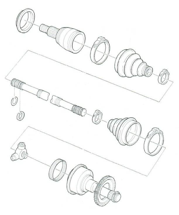

I am bumping this thread to ask a few questions! I am trying to replicate what you have done here. I am also trying to make custom beefy axles on a budget. Few seem to have tried this and there is little information online!
Do you have measurements or specs of the Explorer "37 spline" CV axles? I can't find the specs on these anywhere. I believe they must be a different pitch than the standard axle splines (which are 24 spline typically). If you have the major diameter I think I can figure it out. Maybe these CV axles use a metric pitch?
Were the front inboard CVs off the F150/Explorer different than the rear ones? I wasn't clear if you also looked at the rear axles. I was presuming I could try to use rear inboard Explorer CV's, but maybe these are different in some way?
So did you end up machining the differential housing to take the larger truck sized seal? Actually it sounds like you managed to find a special seal that would fit in the axle housing but had the right ID? That is brilliant! I have a lathe and was presuming I could just turn down the seal diameter but this is easy peasy!
Really appreciate all your work on this. We think alike! Hope you are still on the forum after 7 years :) Looks like you signed in earlier in the year at least!
Yes I am still around. I did that long enough ago that I don't remember the details. I should have all my notes and details in an Excel file on a back-up drive.
Off the top of my noggin, I purchased a Torsen 8.8 LSD that used the larger spline hubs. I did open up the housing to accept a larger seal. (I do have spares and P/N for the seal somewhere.) I recall spending a lot of time finding a seal that would work, then getting the exact dimensional details, and then machining the housing to accept the seal.
I don't recall who made my custom axles. I changed my rear end assembly to use Corvette spindles, so I ended up 3D modeling the complete custom suspension in order to determine the axle length. Before you get excited about, the possability of getting your hands on the models, since I did them after hours at work, our company security system prevented me from downloading the files. (They let me use their Solidworks for my own projects, but I couldn't take/keep the models.) Therfore, I made parts from paper drawings rather than IGES files.
90+ percent sure that these are the seals I used.
451817 by FEDERAL MOGUL-NATIONAL SEALS - Oil Seal
Other details will have to wait, until I can find time to dig out my back-up drives and find the folder that has all the information on that project.
Interesting! Although it would be easy enough for me to turn down the seal surface I think those OEM stubs tend to be just surface hardened... so I am a little concerned they may break where the seal was. That seal is a brilliant find. Just need to open up the diff slightly. The Explorer seals are beastly and would never fit.
The main thing I can't find is the specs on the explorer spline. For some reason except only a few isolated types (like the Porsche CV's popular with the sand rail folks), halfshaft CVs just aren't well documented.
Thanks!
Back when I had my axles made, the splines on the explorer hub were a common size that was in their of tooling selection. The C4 corvette spline was a problem and the shop that made the axles had to order tooling to be able to make the splines. I have probably 10-15 different axles I measured and ran calculations on to find which one would work best. I'll have to search for my files in order to refresh my memory regarding dimensions and who made the axles.
I found nothing regarding dimensions of CV joints. Did discover that the housings are almost all produced in around 5 different sizes, then are machined per the specific application.
You could go the route and have $2,500 to $3,000 custom ones fabricated to your specification and HP rating.
