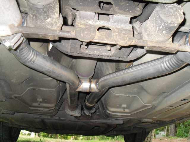

Nope. It is indeed a catalytic converter (that's why it stinks like rotten eggs when it gets clogged - so you cut it off and weld in an h-or-x-pipe and all is well). On the base models, with single exhaust there is a small resonator behind the 3rd cat. LSC models with true duals have a dual in/dual out 3rd cat with no resonator.
Here's my H-Pipe in the place of the 3rd cat on my '97 LSC:
