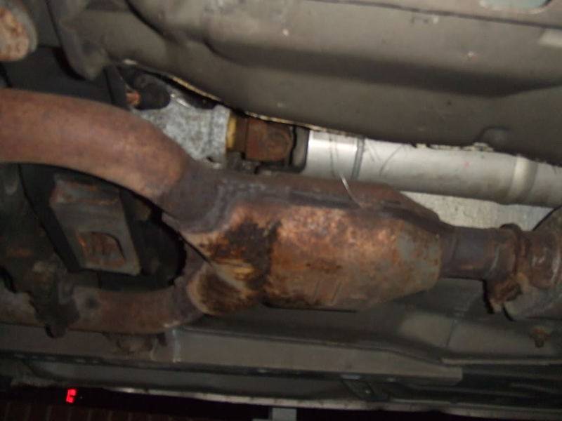

sorry to say, but the 95 has true duels from the heads all the way to the 3rd cat. after the 3rd cat it runs a single pipe. the 3rd cat is a Y pipe thats a cat. also there the resonator right after the 3rd cat.
also, im just looking to get rid of the 3rd cat. its clogged and stinks! and to get rid of the resonator. im not looking to do true duels on this one. maybe later after i swap the heads :gr_devil:
this is off the other 95 that im restoring, 205K miles
