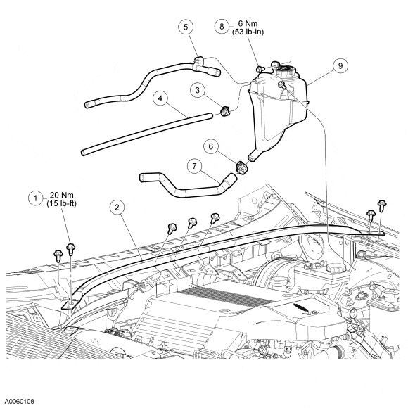

    Anyone have a source for a new coolant air bleed hose ? I've looked and can't seem to find it anywhere. Gen 1

    That's the heater air (manual) bleed hose. Is that the one you need, or are you looking for the engine air bleed hose?

    The 1st and 2nd gen LSes V8 and V6 all have an engine air bleed hose. It runs from the front of the engine to the top of the degas bottle. It is not a manual bleed. It works automatically.
    It is #4 below.

      Like most things, they call it by different names depending on where you look in the manual and in their parts catalogs. I have seen it called "engine air bleed hose." I have also seen "engine air vent hose," and of course just "hose."

      I think that hose is part number
      XW4Z-8276-CA
      XW4Z-8276-CA - Ford Parts Giant

      I need #5 with the plastic screw you lossen to bleed the system
