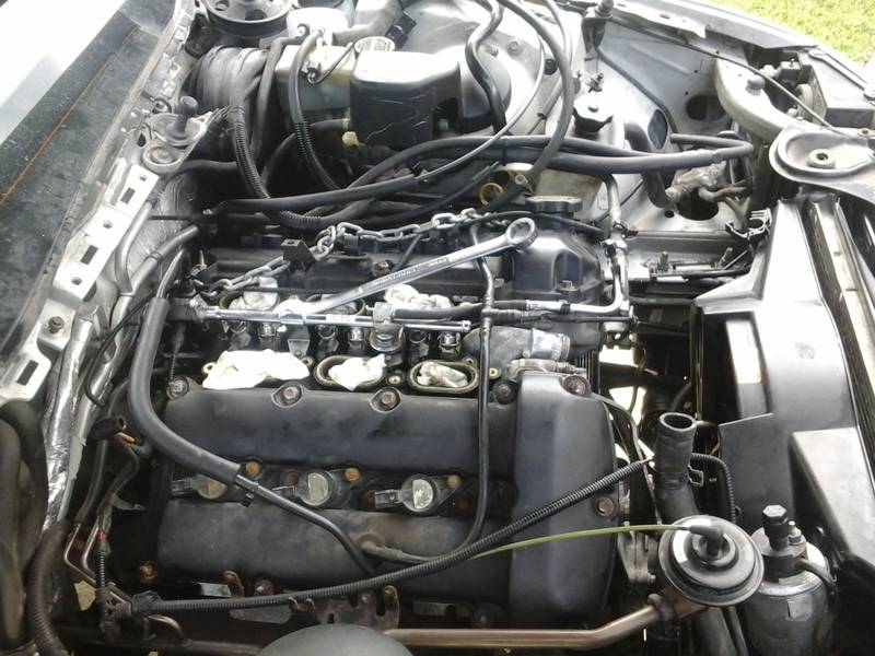

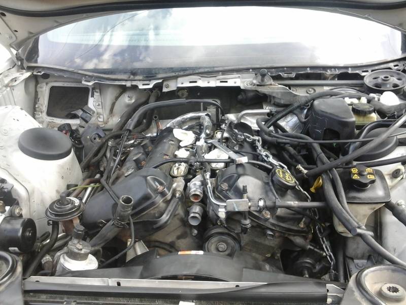

It's starting to look like a car again. Dad and I are "taking 5" with it being in the upper 80's here. Engine and trans went in no problem, just finished mounting the accessories, radiator pack is all together, fan is in place. all that's left really is the cooling hoses, power steering fluid, fan fluid, and install the wiring harness, kept meaning to do that and we'd end up doing something else... oh well it should be too bad with the cowl out.
Coming along nicely, exciting stuff and kudos for sure on taking on this job.
I would replace the coils and plugs before installing the intake plenum.....
IT'S ALIVE!!!!!!!!
While bleeding and doing other checks, I noticed a small leak at the thermostat housing, and I need to change the tensioner. Waiting for it to cool and then, i'm doing those things. Until then, I get to go find a thermostat housing O-ring.....

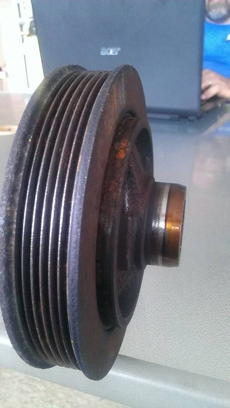

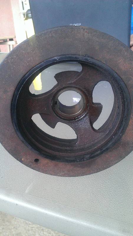

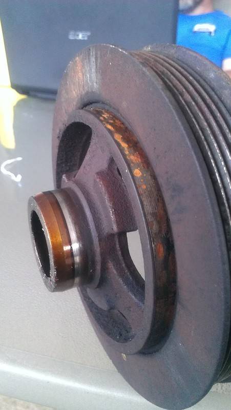

It is now all back together, quiet, strong, and ready for a test drive. Figured out the squeak was a VERY bad crank pulley, pics later when I'm not in such a rush to get somewhere important.
Here are your promised pics! So, this is what the squeaking was, the pulley was so far out of whack, the belt wasn't riding in the correct area of the tensioner. You could see the crank pulley wobbling when it was running
She was looking to separate soon enough by the looks.
On my Maxima winter beater, had the harmonic balancer separate and slide off, chewed up two belts, $400 later ... fun fun fun
