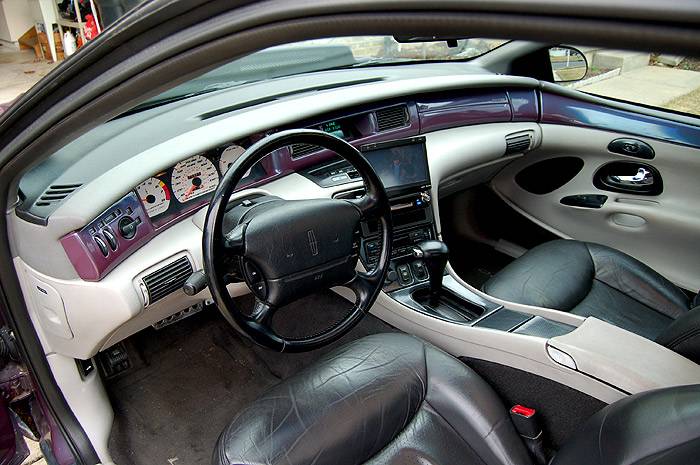

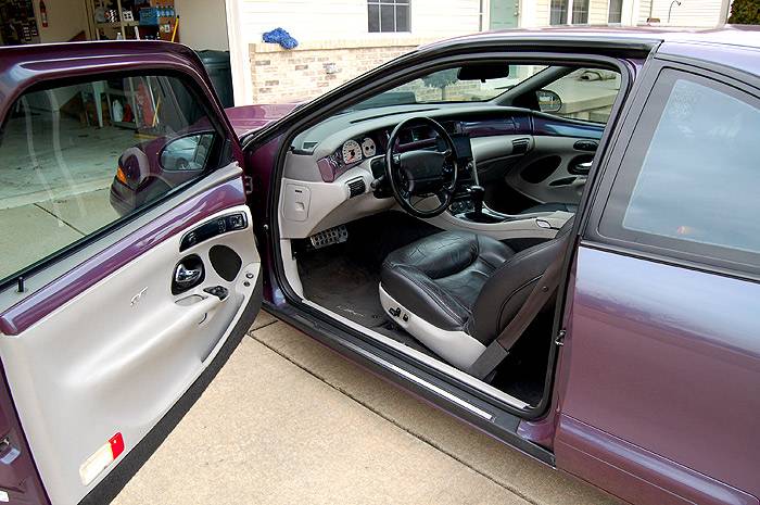

Has anyone tried to fit the FULL 2nd gen interior in a 1st Gen? seats, carpet,lights,dash,panels,the whole kaboodle.
I'm in the process of the door panels right now. I did some recon last weekend to see what kind of a wiring nightmare I'm about to get into, and I'm going to try my passenger door panel this saturday.
I'm sure the seats & carpets would be no problem. Dash & telescoping wheel would be fun, I can tell you that, lol.

BTDT in my car, carpet is different, headliner is different, dash is just short of impossible Not worth it at all. Even the seats didnt work. I had to "reskin" my Gen 1 seats with the Gne 2 foam and leather. PITA.
