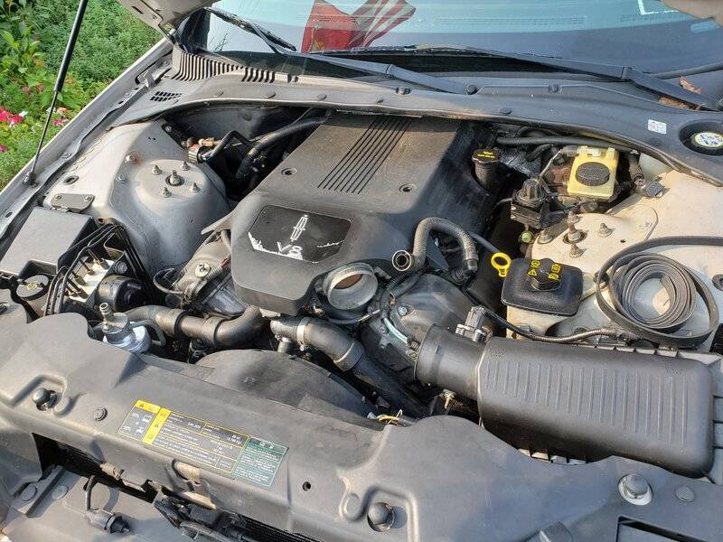

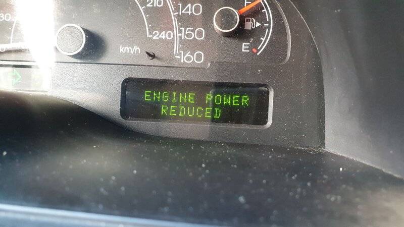

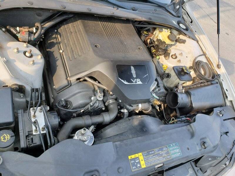

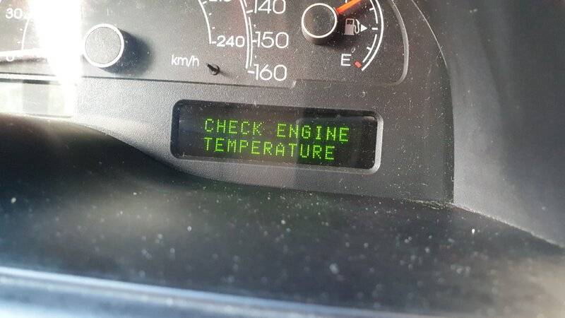

So I bought the LS for my son in May, 88K on the odometer, clean carfax. Had it inspected, no leaks, no issues. A month later the power steering starts to make a groaning sound. We replaced the PS pump, a week later, the noise came back. Notice the PS fluid level was low, and there is a leak coming from the PS boot (I assume the rack needed to be replaced). Then my son takes it for a spin, with the PS leaking and he hears a rattling sound coming from the engine. He pulls over, and sees these 2 notifications on the dash.. Now the car will not start. Lights come on, makes a clicking sound, but will not crank. Had it towed to a local mechanic, who fears the engine has seized.. Is this the end?
Also, we had a leak in the sunroof, water dripping into the cabin? Maybe the engine is hydrolocked?
end?

Also.. we checked the oil about a week prior, it was full, a bit over the max, and now we checked, it is very low.. So something must have caused a pretty bad leak very quickly?
I would start by removing plugs and manually turn the crank and check cylinder compression
So, I assume that the temperature gauge was ignored?
somehow lost all oil
or overheated to the point it dropped a valve seat
As soon as he heard the noise and just before he shifted into neutral and turned off the engine, he checked the temp gauge. It was right in the middle (as it should be.) After coasting to a stop at the side of the road, putting the key into the run position revealed, in addition to these two messages, that the temp gauge was maxed and the temp light was on. Just 15-30 seconds prior, the temperature gauge indicated no problems at all. Is this salvagable? Or a total loss? Common issue? We are bumming right now..
... Is this salvagable? Or a total loss? Common issue? We are bumming right now..
No, not common. You have not provided enough info to know if this is minor or major. A good next step would be to put a socket wrench on the crank bolt and see if you can manually turn the crankshaft clockwise. If you can't, it probably is toast.

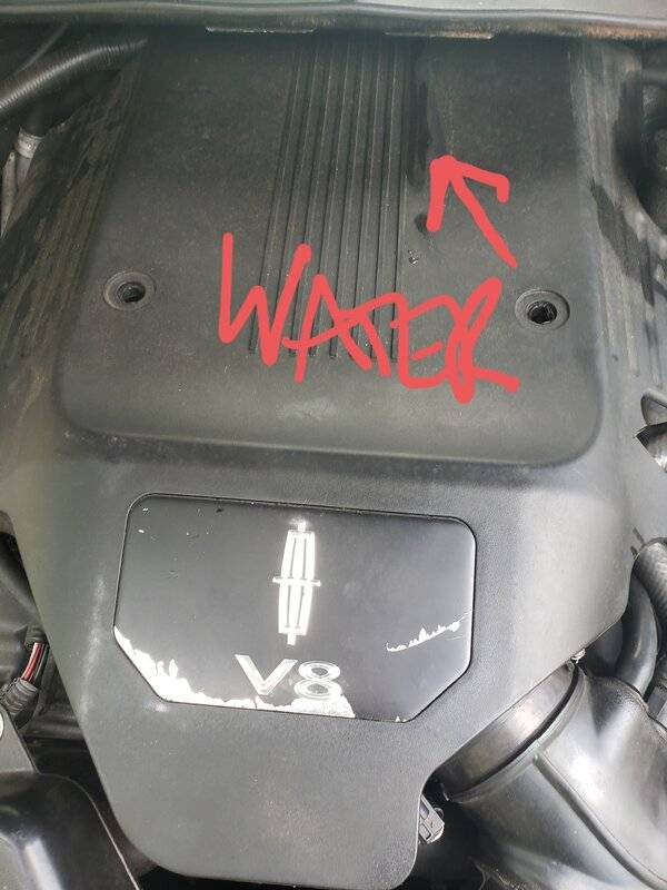

The day before it died, we had a lot of rain, and water leaked in the cabin and all down the front pillar..
One theory is that we have a short somewhere?
He recommended I take the battery to AutoZone, and have them charge it, or try a new battery...other than that I think I'm stuck.
If the sunroof drain came loose, (which they are known to do), on the passenger side of the car... (IIRC) the water will run down to the ECM and potentially fry it.
Get the right sized socket and a fairly long ratchet... and put it on the crankshaft pulley bolt (as Joe suggested) and try to turn the crankshaft.
You'll know if it's seized.

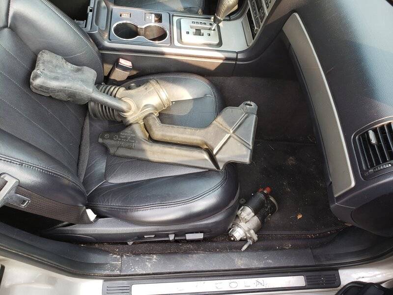

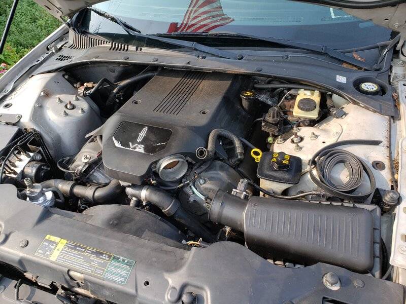

Soo....got the battery charged at AutoZone, no good news ...car lights up, but only clicks, no crank.i think she's dead...but noticed water under the hood, (likely from the sunroof leak).any chance this is electrical, not mechanical failure? I'm going to try to hand crank one of these days in the next week or two..but seems like a fair amount of work, which I haven't had time for yet.
Had a mechanic come to the house, who took a look, but didn't have time to try to crank it manually.
Might be easiest to crank it over from underneath.
