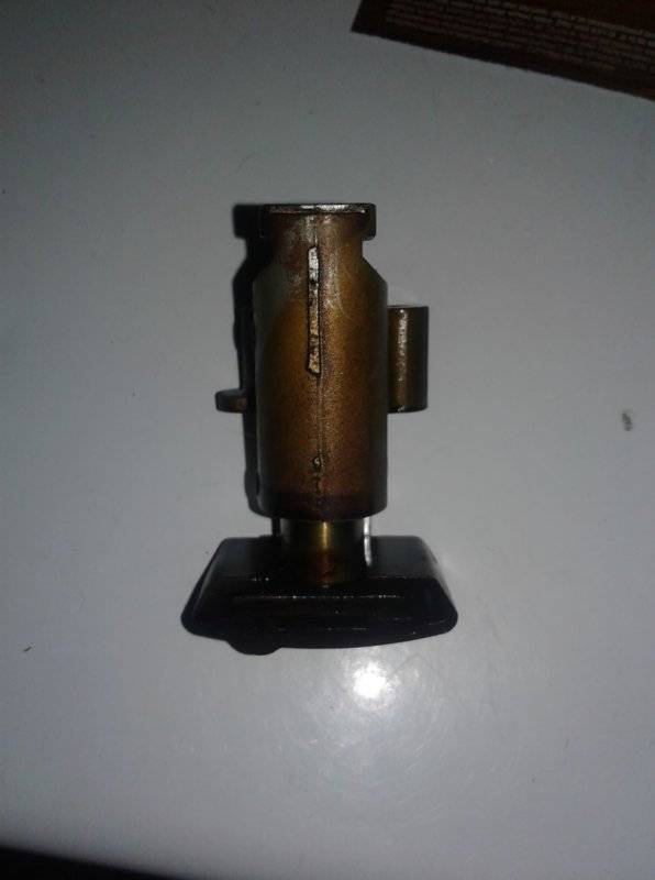

I thought my issue might have been timing chain related but got one side fixed today (have not tried to crank yet) and gonna do the other side tomorrow I am talking about the upper tensioners the passengers side one looked like
Yes I know that is bad but the timing was pretty much still spot on. I won't know for sure the shape of the other one till tomorrow once I get the fuel line out the way so I can remove the other sides valve cover. I am assuming it's gonna look about the same, cause the passengers side was not actually making any noise. I was having some noise on the drivers side prior to the car not cranking so I had prepared to do this before. But like I said I am assuming only cause the timing was dead on other than the lack of the top of the tensioner being there which corrected soon I got the cam back in place.

Ok, then I am really hoping it was the tensioners being worn out. I guess time will tell tomorrow on if it will crank or not once they are replaced. And yes I am sure I do need a better mechanic but money is tight right now and he is usually are pretty good with cars. (He is also a machiner so he usually knows his stuff) This was the only time I have seen him be wrong about something. He was just likely assuming cause I know he said he has not worked on this type of motor much in his time. I have never heard any tapping or ticking anyways other than when the oil got low cause of the oil leak. But when full of oil like it should be it always cranked clean other than the sound of that worn secondary tensioner.
The car did not sound horrible when it tried to crank, it just sounded like a chain not going where it needed. And a few times it got close to cranking but I figured I better stop, I did not want to risk any more damage. The car cranked fine until it got towed home cause of the serpentine belt being worn cause of the old oil leaks. So hoping the tensioner just got out of wack cause of that. I mean not sure if that really could have happened but the passengers side was pretty jacked up overall and the top was missing (was in my oil pan)
