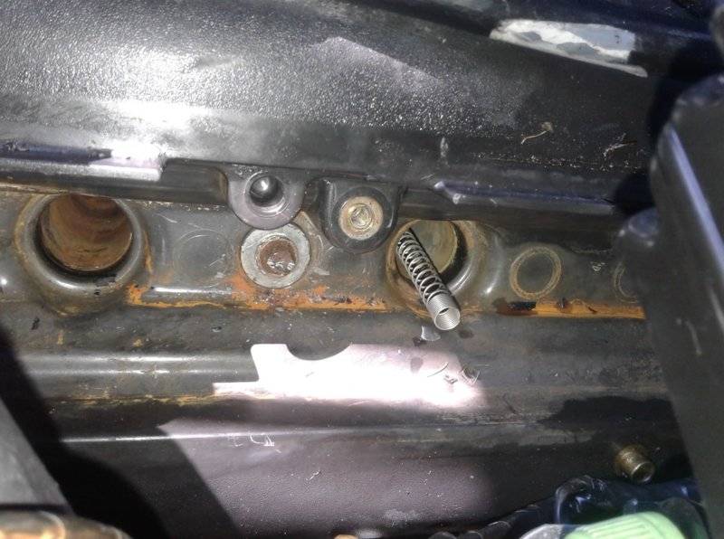

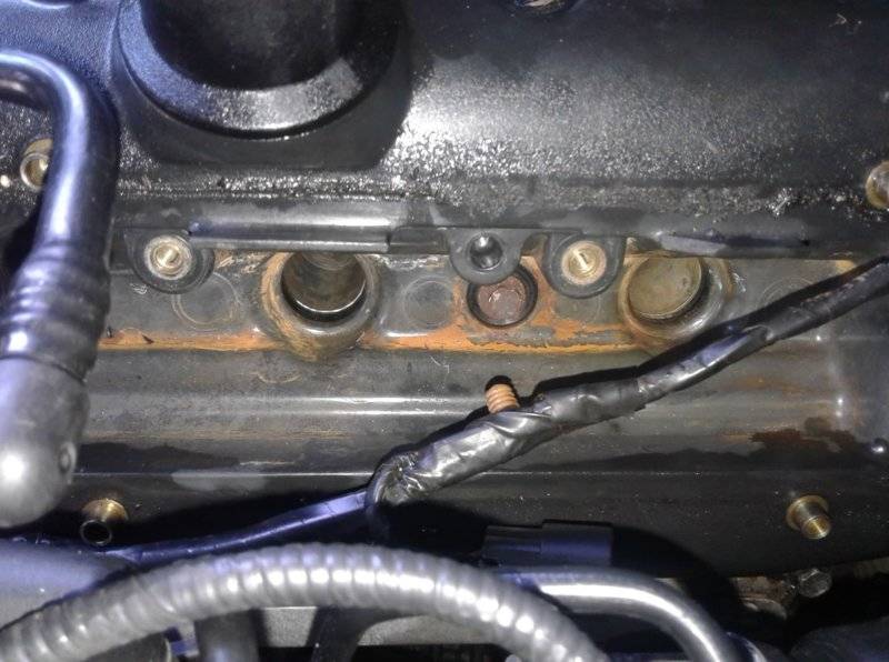

I was trying to change out my valve cover gaskets & secondary tensioners. I have all the screws broke lose expect for the two in the coil pack area that hold it down. The issue is the previous owner has put in different bolts and they are stripped out can't get any socket on them to turn them. Bought several different stripped bolt kits and nothing works the closest thing was the Gator Socket but the issue was it can sit flat enough to grab the bolt. Does anyone have any ideas how to get them off.

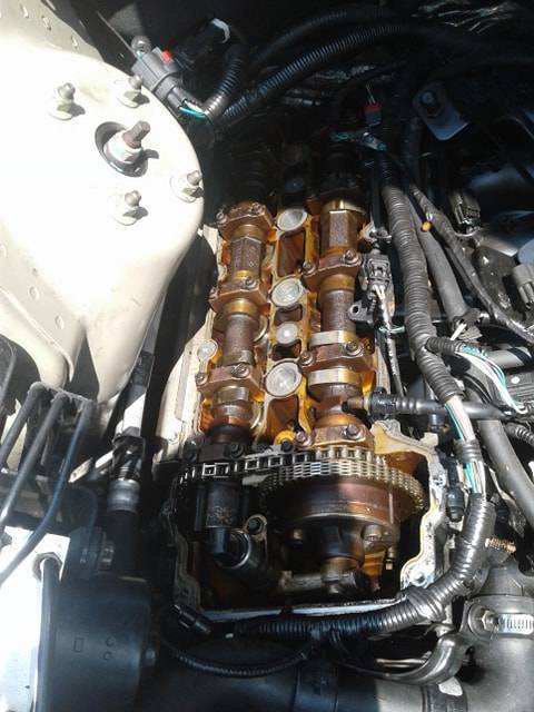

I got the passenger side off without any issue. It's the drivers side that is being a pain.
Maybe something like this?
Industrial Boys
Cut the heads off with a Dremel? This may damage the valve cover too much to be able to reuse it. Once the cover's off, you should be able to screw the bolts out with some vise-grips. This assumes that the bolt threads and/or head threads aren't damaged.

I was thinking to maybe try to take a Dremel and notch out a line for a flat head screwdriver and hope it comes out. I am to the point where I am just gonna have it towed to a mechanic. Cause had some issues getting the passengers side tensioner to tighten up to the chain, there to me still is a bit too much slack. That tensioner should be tight to the chain correct?

Got the valve cover off finally and discovered that the upper chains need to be changed cause one side was stretched. This means that I would have to do the main timing chain as well right. I am gonna do the main chain either way since both upper tensioners were broke. And I am about to order the parts and the gasket for the cover. Does anyone recommend anything else while I am down there? I should really say I am gonna have a mechanic do this I just wanted honest feedback on what else should likely be done. She has around 245,000 miles on her and I think she still has a lot of life in her, and plus the mechanic kinda owes a favor anyway. And this mechanic has worked on a bunch of Jaguar Motors so I feel safe with them doing it.

There are four chains. Two primaries, one for the intake cam on each bank, and two secondaries, one from the intake to the exhaust on each bank. If one bank needs chains, then I would do the other bank at the same time. There's very little added labor at that point.
