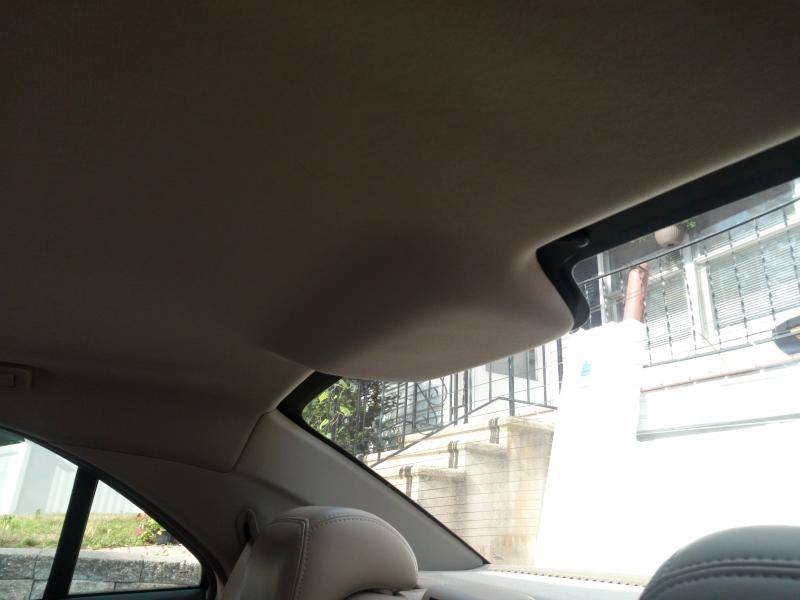

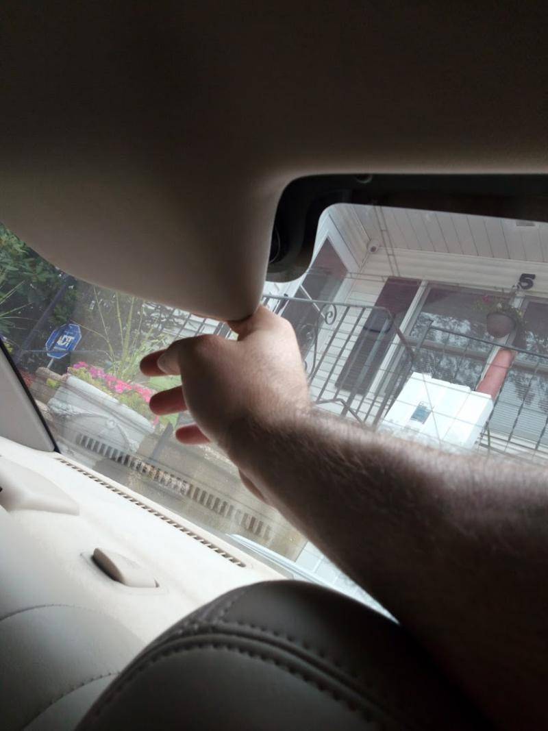

Hello Lincoln LS community. I am going to take a shot in the dark here and please forgive me if this is a question that has already been asked & answered.
By the 3rd brake light in my 06' LS the headliner has come undone and now just flops up and down when the windows are down.
Is there any special hardware (screws, clips, etc.) that holds that portion up or would it just be glue? If hardware do you know the part numbers? If glue, any suggestions on what type of glue/tape I should use? Please see below for pictures of what I am referring to. Thank you very much for your help in advance.

Resolved, maybe this can help you amorgan2017. If you're on the bigger side like me (5 10", 225 lbs) its a major PIA to get under the headliner back there since there's so little room. Putting the seats down doesn't help much either. Sweating, cursing, and focusing on the end goal does though :D. Basically, there are 3 attachment points back there. Facing towards front of car, one towards the back left, one in center near 3rd break light, and one towards back right. They use Velcro to hold it in place. The hook side is clipped into the roof & the loop part is glued onto the headliner from the factory. In my case, the glue had failed. So I simply removed the 3 loop pieces, applied some gorilla glue on each, and got them back into place, let them cure and pushed the headliner back into place. I took it on the highway and hit 70 with all windows down + sunroof, no more flapping headliner! :D The biggest pain is getting under the damn thing but other than that, looks like I'm all set. Hope this helps.

Yeah man, its a total PIA. Its amazing how big this car looks from the outside but how cramped it feels on the inside. Try putting the little seat down (one closest to rear passenger door). That will give you a little extra room to maneuver. I'm willing to bet the original hardware is still in there for you, just the headliner glue has come undone. If you can avoid gluing it back up I would due to the fact that access to the 3rd brake light is through the headliner. God forbid that bulb goes out and you have to replace it, good luck if its glued to the roof :Bang. Gently pry the liner down while you're back there (not too hard or the cardboard might bend/break) and try to glue the headliner pieces back onto the headliner where they were originally so they line up with the top "hook" piece. Let cure, then push into place.
thats the way i did it, I put the glue/epoxy on the bottom piece (since the top was still held on fine) and then got in the car, sat in the middle and reached above my head and stuck it down to the headliner itself. the key was that I did not try to push the head liner back up yet, just glued the velcro piece to the headliner, then the next morning after the epoxy had time to cure, I pressed the two back together.
