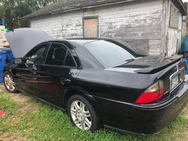

    image.jpeg image.jpeg image.jpeg image.jpeg image.jpeg 2003 Lincoln LS 99,000 miles ....starts one day and then won't ven crank over the next ...when trying to start only the airbag light comes on and security system light ....the guy says that dealership told him it's the computer ....does this sound right? Beautiful car black on black with spoiler

    Not my car it's a potential purchase ...This LS has intermittent starting problems. Sometimes it will start no problem and other times it won't even crank. When the guy turns the key as I said in a earlier post all that lights up on dash is security and air bag light.

    the car's exterior looks phenomenal from the pics, im sure the interior could be cleaned up well too.
    if you figure this out, let us know. would be a good buy.
