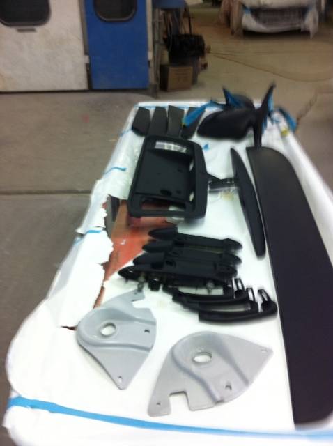

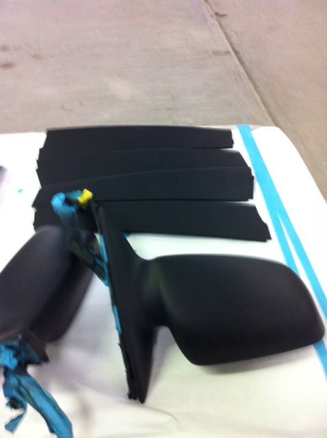

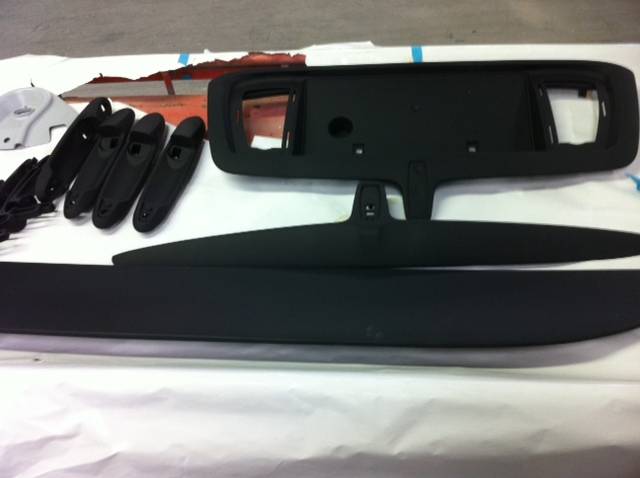

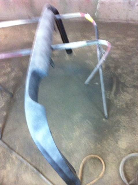

Ok project was on hold but is underway again. Priming parts and sanding underway
Ok some additional photos sorry about the quality. The spoiler was prefit to the rear trunk lid yesterday and fits like a charm

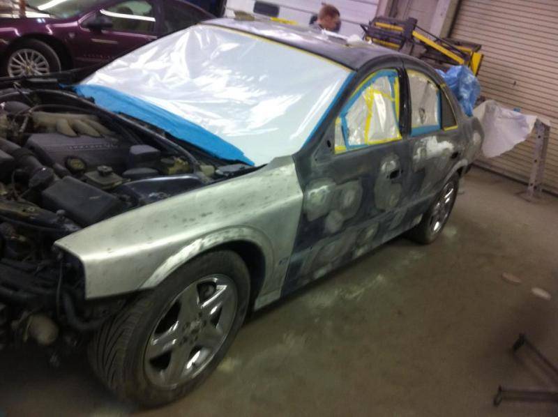

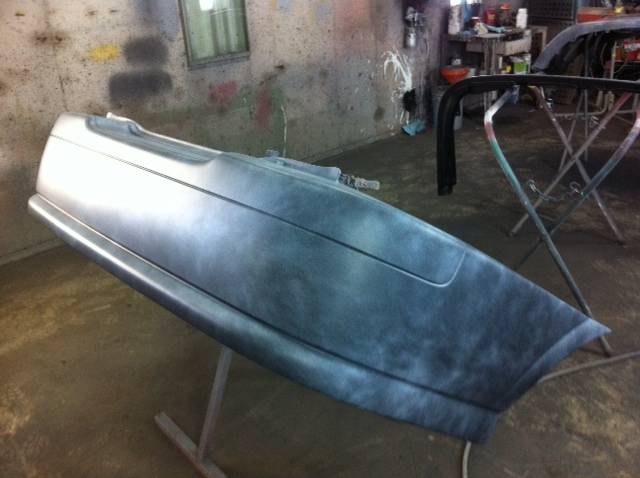

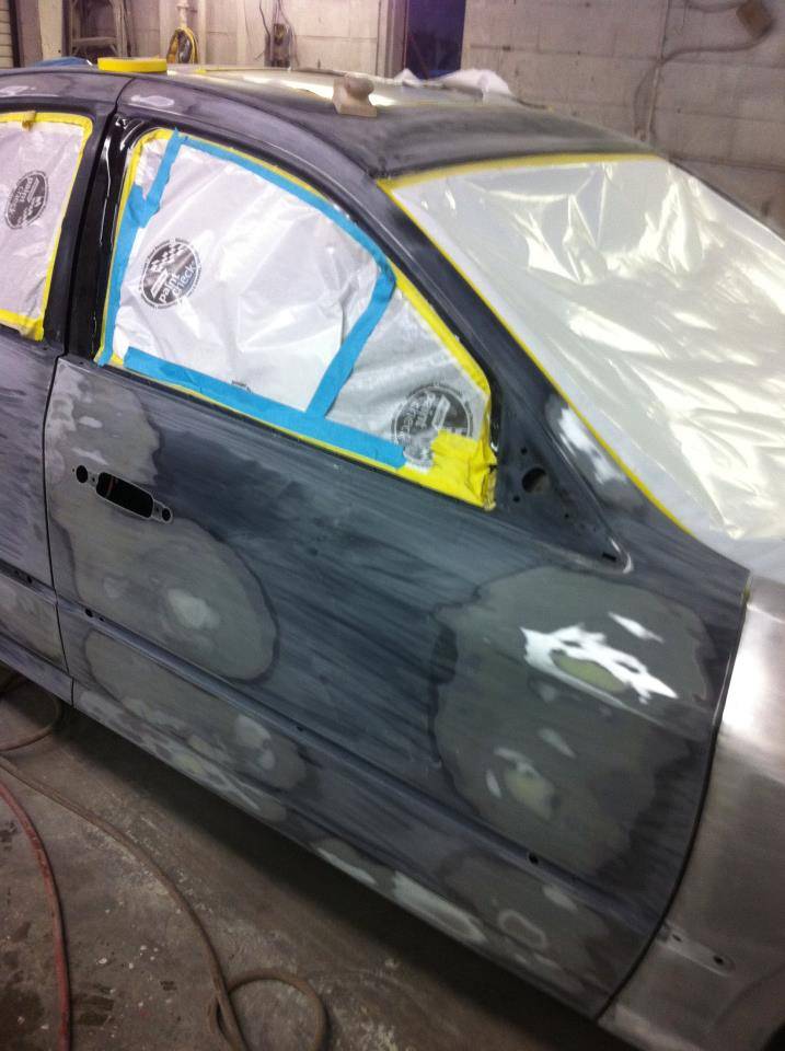

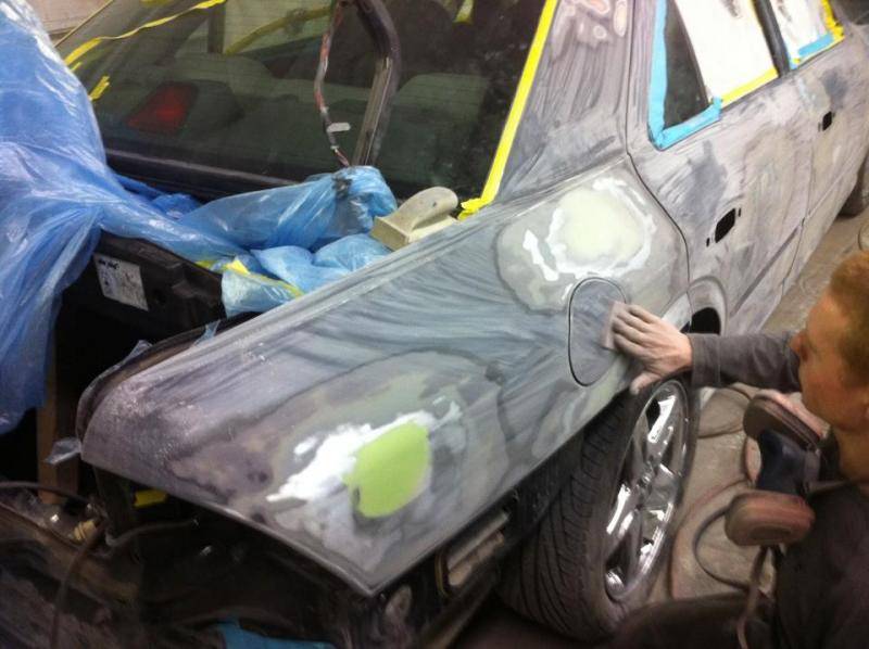

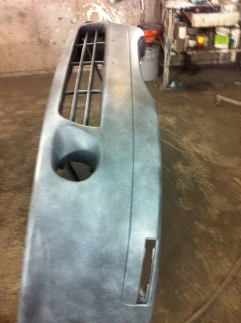

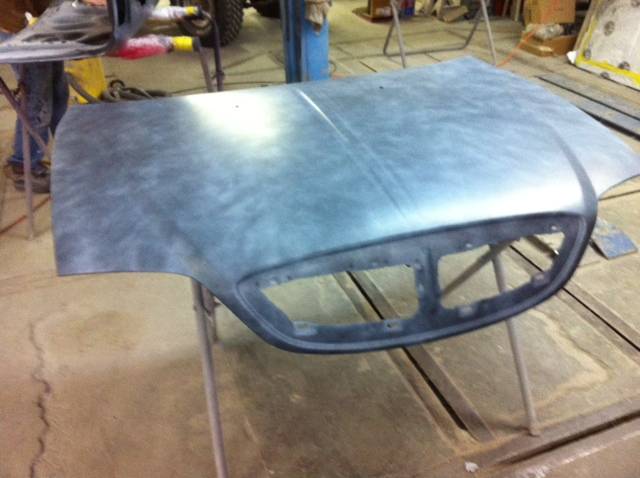

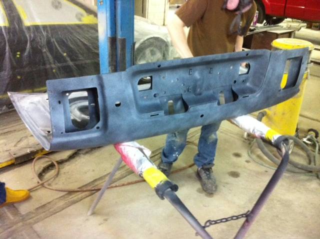

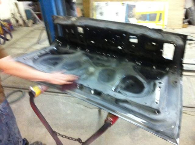

The prep work is amazing he wants the car to be finished show quality because his shops name is going on it. After a complete pre-sanding of all the parts, the parts are being "black" primed and "white" spotted so any irregularities can be seen and taken out. The work on the hood to get it perfect was almost 6 hours and the trunk lid will be the same. The hoods had some dimples from we figure when the car was exposed to a hail storm and the alluminum hoods are thin at best compared to todays manufacturing. All the primer materials and paints to be used will be glasurit - they say they wont spray it in anything else

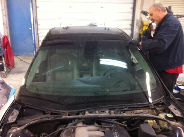

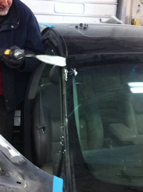

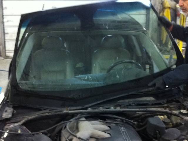

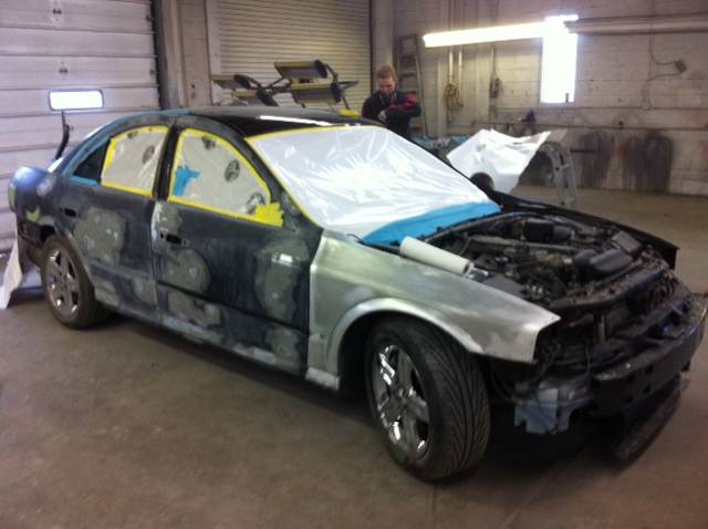

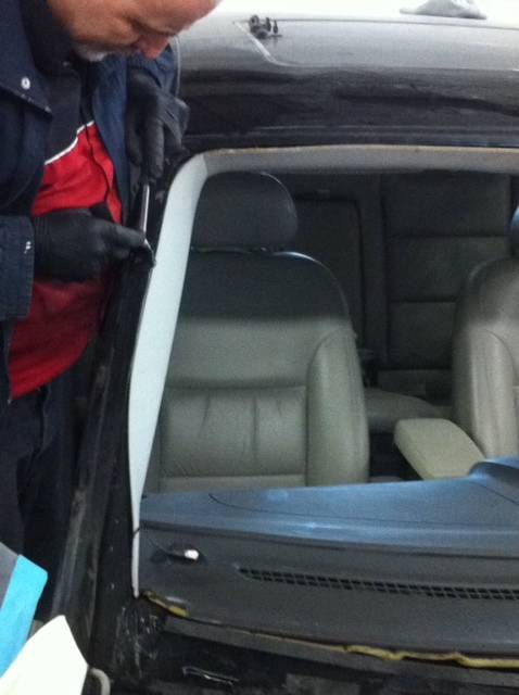

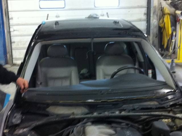

Well I discoverd a chip in the lower windshield today and decided that it would be better to change out the windshield now before painting. If you look closely at one or two of the pics you can see where the whiper blade heater wire connectors are located and the removal of the rain sensor took a bit of messaging but we got it off with the help of a local glass repair specialist. With the front window out we are now sand blasting all along the window frame opening to make sure that no rust ever starts and to make sure we get good paint adhesion around the front window frame. Sun roof will come out later today. The entire car will be primed and blocked tomorrow after we finish the base sanding and stripping.
:mad:

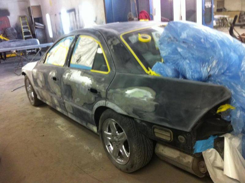

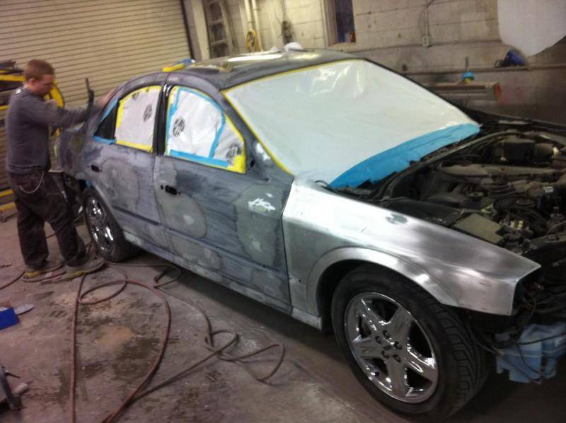

Found a crack in the passenger fender at the bottom just where the profile changes after the trim recess. Going to call in a local old boy that is talented alumimun seem welding. Besides that the blocking and sanding goes on so much so we are working until about midnight our time in hopes we can prime in flat black tomorrow morning.

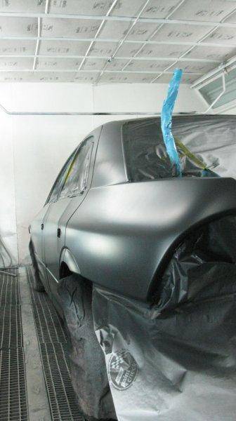

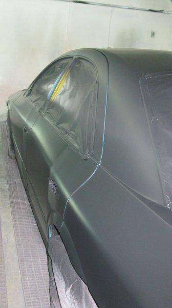

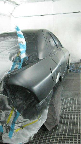

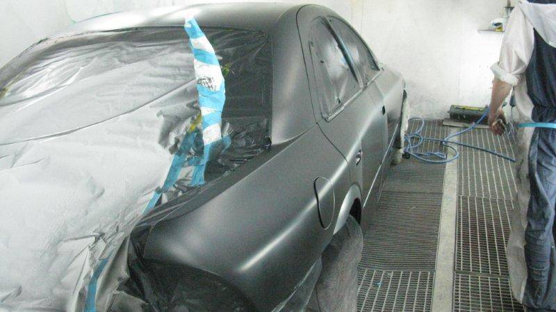

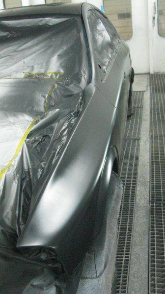

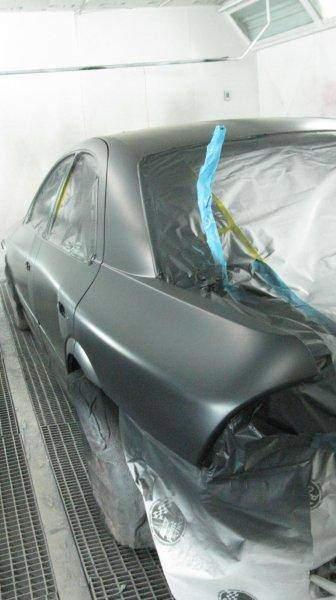

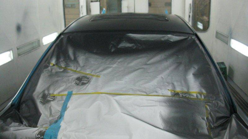

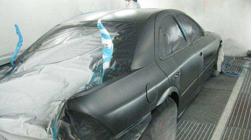

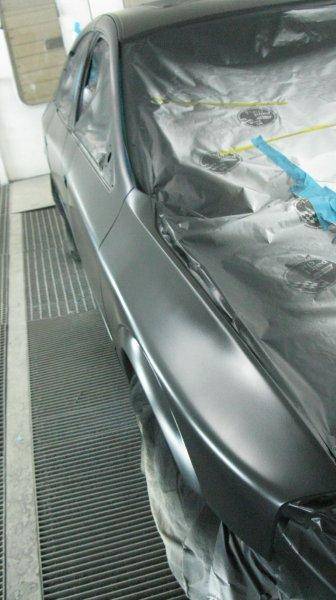

Primed and Ready for Blocking

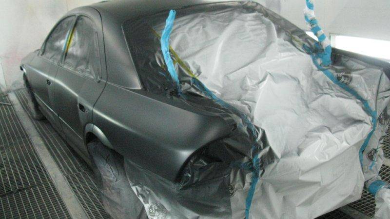

Ok so after three coats of flat black Glasurit primer she is ready for three hours of baking, two days left standing to harden so we can start blocking. We are going to block the panels then re-prime lightly to make sure we got it flat and straight. No screwing around when you go black it has to be perfect!!
