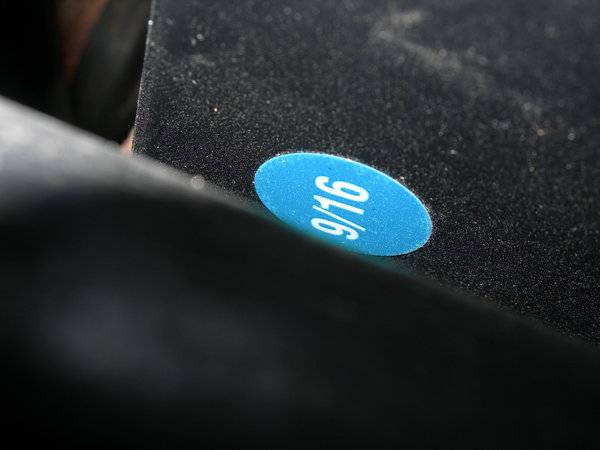

Yeah,,, on most batteries... there is a round sticker on the side. It is a date code for when the battery was made. My truck was easier to take a picture of... but I haven't seen a battery without one for a decade or so now,,, unless it was peeled off.
