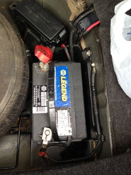

Can you post a picture of the battery (installed in your trunk)?

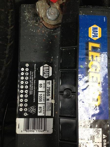

Noted. The battery in the car is a "Napa Legend." Any idea if that's the correct type?
Although a battery, potentially not the correct one for this car.
For safety reasons because the battery is inside the car in the trunk, it must vent to the outside.

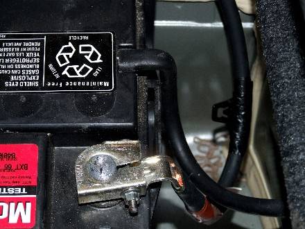

At the Negative terminal there should be a nipple where the vent tube is slid onto.

Unless I'm mistaken, it seems like the battery I have has that tube
Technically not the right battery, but it is close, and may be close enough. You do have the vent connected, which is good. The only concern left is that it looks like it is a group size 65N, instead of the called for group size 66. The difference between a 66 and a 65 is that the 65 has two vent connections. If both of those connect internally, then you could just plug off the unused one and be good to go. If they don't connect, then you would have to tee in another vent line to the other connection. (They probably do connect, but I would want to be sure.) I don't know what the difference is with the 65N.
Anyway, is there an open tube connection near the positive post, like the one at the negative post?
I think this is fairly moot, unless you are set on replacing it with another Napa battery.
I'm not seeing a second tube type thing near the positive
