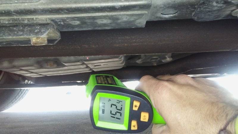

What temp should my transmission be running right after driving? Just cruising, not going crazy fast what temp? Anyone know or have checked their trans temp after running? I know you can do it with a scan tool too.
I believe that anything less than 200F is considered okay.
