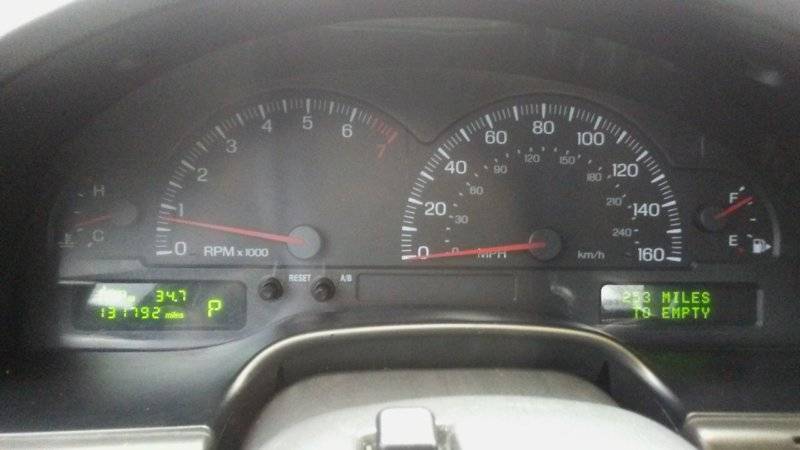

    It downshifts fine. And it runs like a champ.130,000 miles.i didn't move the idle adjustment bolt. I've never had any engine problems.only routine maintenance.which I've done myself.inner,outer tie rods,upper,lower control arms,oil change,airfilter,spark plugs,timing chain,coils,PCV valve,brakes,rotors,etc.never done anything to the tranny its sealed and doesn't leak(never checked fluid level) What im describing is, the car is fast as shit. When you put it in d5 and drive the car the engine and tranny run flawlessly at speeds up to 120 if I wanted. I've had the car for 6 years and it gets driven everyday. When your going 60 mph and let off the accelerator you start coasting correct?then when you gently press the accelerator again the rpms jump from 1500 rpm or so depending on speed to almost 2000 rpm then back to 1500 rpm at which point I can feel power to maintain speed but its very fast rpm transition. It downshifts fast and has more than enough power. Just kind of feels like its slipping out of gear for a split second then reengaging but only does it in high gear could this be the torque converter.?im even getting 26 mpg at 70 mph! It does this rpm change at any speed above 43 mph or so when driving gently, pressing gas then letting off, then pressing the gas again.I know alot about this car. My wife had been driving it for about 3 weeks because her car was hit when parked. Now it does this in high gear and i don't remember it doing this before. its very subtle tho. she doesn't even notice it but I do. I know something is failing most wouldn't realize it had a problem. Want to find and replace faulty part. not taking it to ford.

    It idles perfectly at 750.does anyone else with this car,2002 Lincoln Ls 3.9L notice this is, it normal or not?
